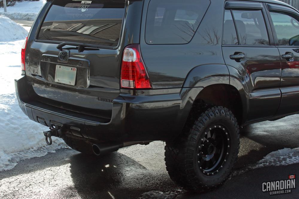

I've had the stainless Gibson exhaust on my V8 4runner for a couple months now and wanted to share my thoughts on it. There seems to be differing opinions here on the forums on whether or not it drones - and in my case it does. It doesn't annoy me enough to consider it a problem though. Overall, I'm happy with it.

Great build quality with sturdy stainless steel
Nice price
Subtle, yet aggressive sound
No rasp
Good fitment
Simple install
Awesome combo with Doug Thorley headers
Stealth appearance with Elite Black Series tip
Cons:
Noticeable drone around 1800 RPM
Slight issue with the angle of one hanger
Lifetime warranty might not cover all real-world conditions

I went with the Magnaflow catback because it has, IMO, the best looking side exit exhaust available and wanted to be able to have my rear window rolled down and not get the exhaust smell. It also droned pretty bad.
But, I got the Vibrant Ultra Quiet resonator (also stainless steel) welded in just in front of the magnaflow muffler and it helped quite a bit with drone from 1700-2350ish rpm. Got the idea from another member who had the magnaflow kit and had drone issues.
Might be worth giving it a shot. It looks like you have room to install it behind the rear axle as well if you don't want to do it in front of the muffler. Vibrant also has a bottle style resonator that won't quiet it as much, but is a bit smaller and might look better behind the rear axle.
