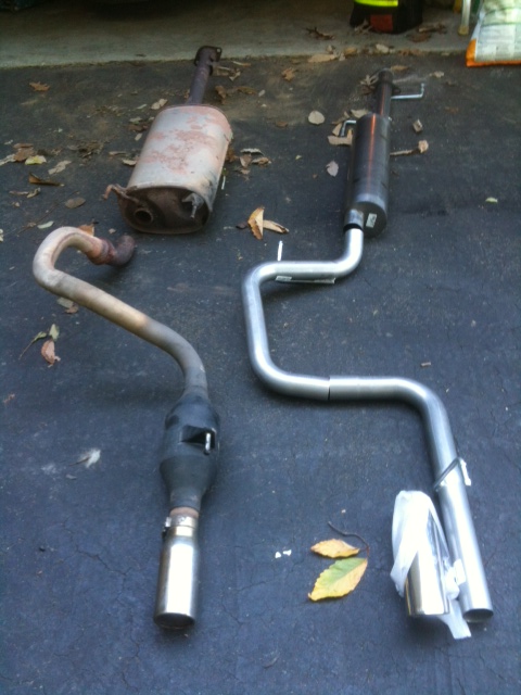

So my stock exhaust had changed pitch recently, and I could hear an audible leak when I stepped on it, so I knew the clock was ticking. Little did I know that time had already run out, and when I found the tailpipe hanging loose while washing it, my hand was forced. Like many others, it had rusted off completely right behind the muffler.

Disassembly wasn't too exciting, aside from the two bolts needing some heat from the propane torch before giving up, and one of the hot springs falling on my hand, but the install turned out to be a bit dicey. The ends of the muffler didn't fit in the adjacent pipes! I know the clearances are supposed to be tight, and they were packed very well in bubble wrap, so I'd be surprised if they ended up out of round due to shipping, but either way, they didn't fit. It took an hour or two of cursing and banging and twisting, but I eventually got them together. I didn't trust that they would go back together if I took them apart again to assemble while under the truck like the instructions suggested, so I left the first three sections assembled and wormed it up and over the rear axle as one piece. The tailpipe extends almost to the edge of the bumper itself, so when you slide the tip over it you can very clearly see a lot of tailpipe inside the tip, but realistically I'm glad they included too much material than not enough. I'll eventually trim 3-4 inches off of it so it looks cleaner inside. Overall, more excitement than I was expecting, but not too bad.

Pic for views, and yes, I know that the first pipe is laying upside down and the muffler is on its side.
