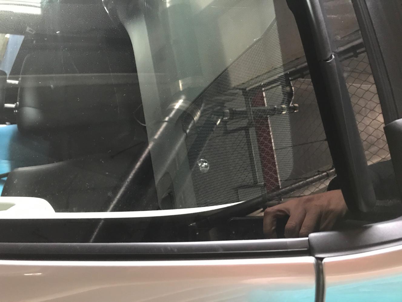

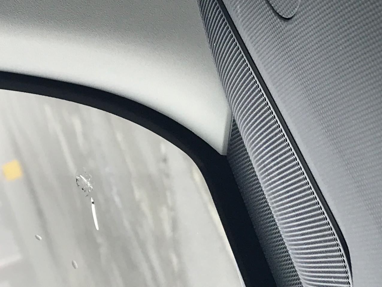

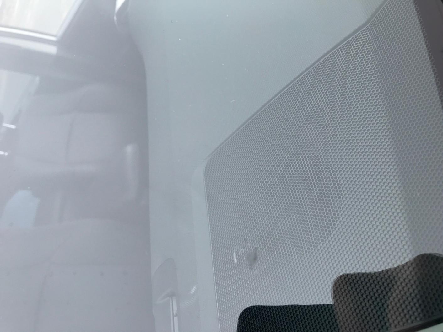

Can’t share the positive experience. Now I’m thinking, why should I replace entire windshield? Is it possible to re-repair their SO CALLED “REPAIR”? Will try to pst few pictures.
1 st - original chip
2nd right after repair
3rd after 1 min of driving
As you can see it's a really bad job. So my question is: is it possible to redo it over and fix that crack, rather than replace the whole windshield?

Edit: once the crack in glass starts to run like it has, it will continue to do so until the stress is fully relieved. This usually only happens when the crack reaches an edge. Chips aren’t bad to fill and hope to avoid crack propagation, but once the crack has started, it’s better to replace.

Regardless of that, because of the crack there is nothing you are going to be able to do to repair it. Once the crack starts, that is it.

I would never recommend trying to repair a crack. One thing with the windshield that is often overlooked, it is a significant component to the strength and structural integrity of the front of your vehicle. Glass is incredibly strong until it has even the smallest micro-flaw.
