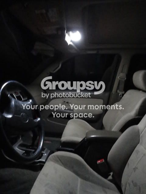

Im running some BA9's that i got from VLEDS and im happy with them! no cutting or modifying needed.
2501.jpg~original
004-4.jpg~original
I got some smaller 2 Led's for the domes and they're brighter than stock but nothing compared to the Ozinum ones. those things are sweet!
