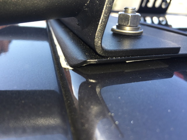

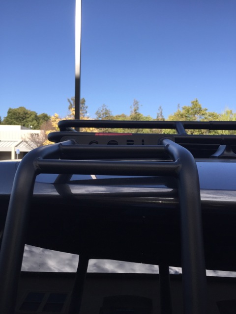

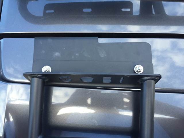

Should I be worried?
Put my ladder up yesterday, everything was flush, level (beides on step that isnt exactly square).
Went out this evening and the top of the ladder didnt look level anymore. Climbed up and found the bracket on the ride side has shifted up and now the ladder isnt sitting flat on the top.
Is this going to cause any issues? Anyone else experience this?

I did the same but then that happened. I have no Idea why, you can see the white adhesive was over the edge and lined up right. Im going to email Gobi to figure if its an issue or not.
Sorry I somehow missed your post when I replied. It looks fine to me, but might be better to get some input in the 5th gen section.
As long as it feels sturdy and doesn't contact the paint anywhere it shouldn't, you should be fine. I believe mine shifted slightly after installing it so that the adhesive is showing too.

No worries, and yeah its solid no rubbing I can tell of, just moved after the install. Thanks for the help
