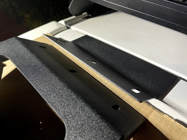

Install was pretty smooth until the very last step. I think EVERYONE has trouble with the last 4 bolts because it is such a tight fit. I think v2 of this ladder with def need an adjustment because I needed to go get a 24" adjustable wrench to get some leverage. It also comes with no documentation or instructions, and none on their website -- just YT videos you have to find yourself.

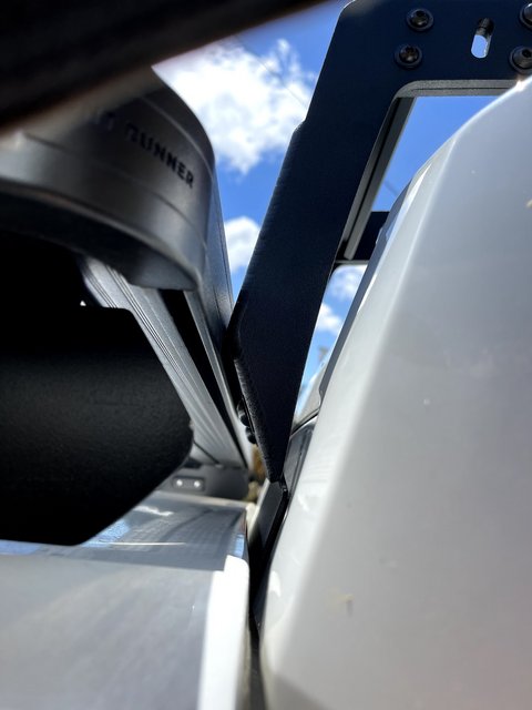

Another issue I ran into is that at full open it does hit the back of my Front Runner roof rack. If you installed the roof rack yourself you will remember in the directions to slide it as far back as possible -- well that will cause it bump into each other. I need to take everything off and slide it forward to clear which is a pain in the ass.

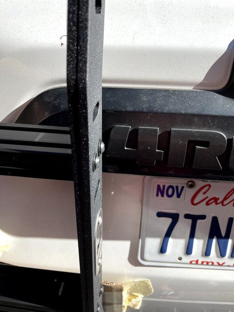

I like how it lines up with the "4"
If you install the bottom first this is how much gap there is that needs to be made up by flexing top plate to make it fit (apparently as designed)
Bumping into my Front Runner roof rack

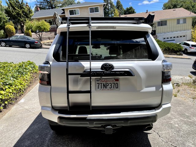

Final product
