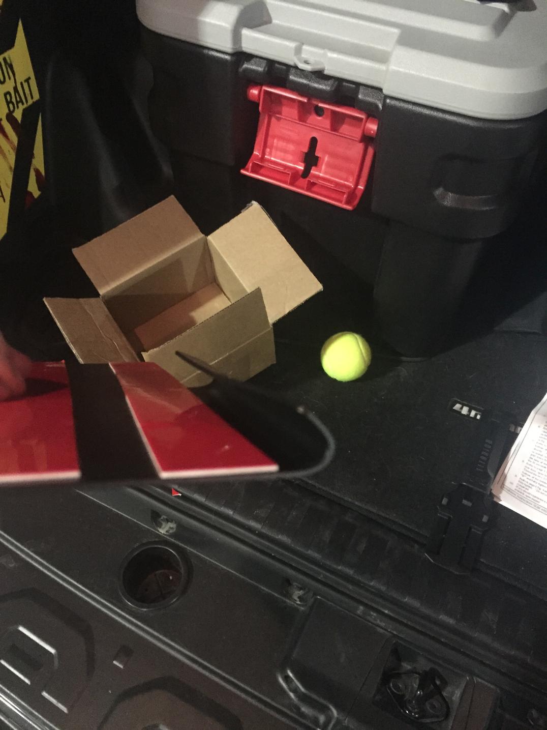

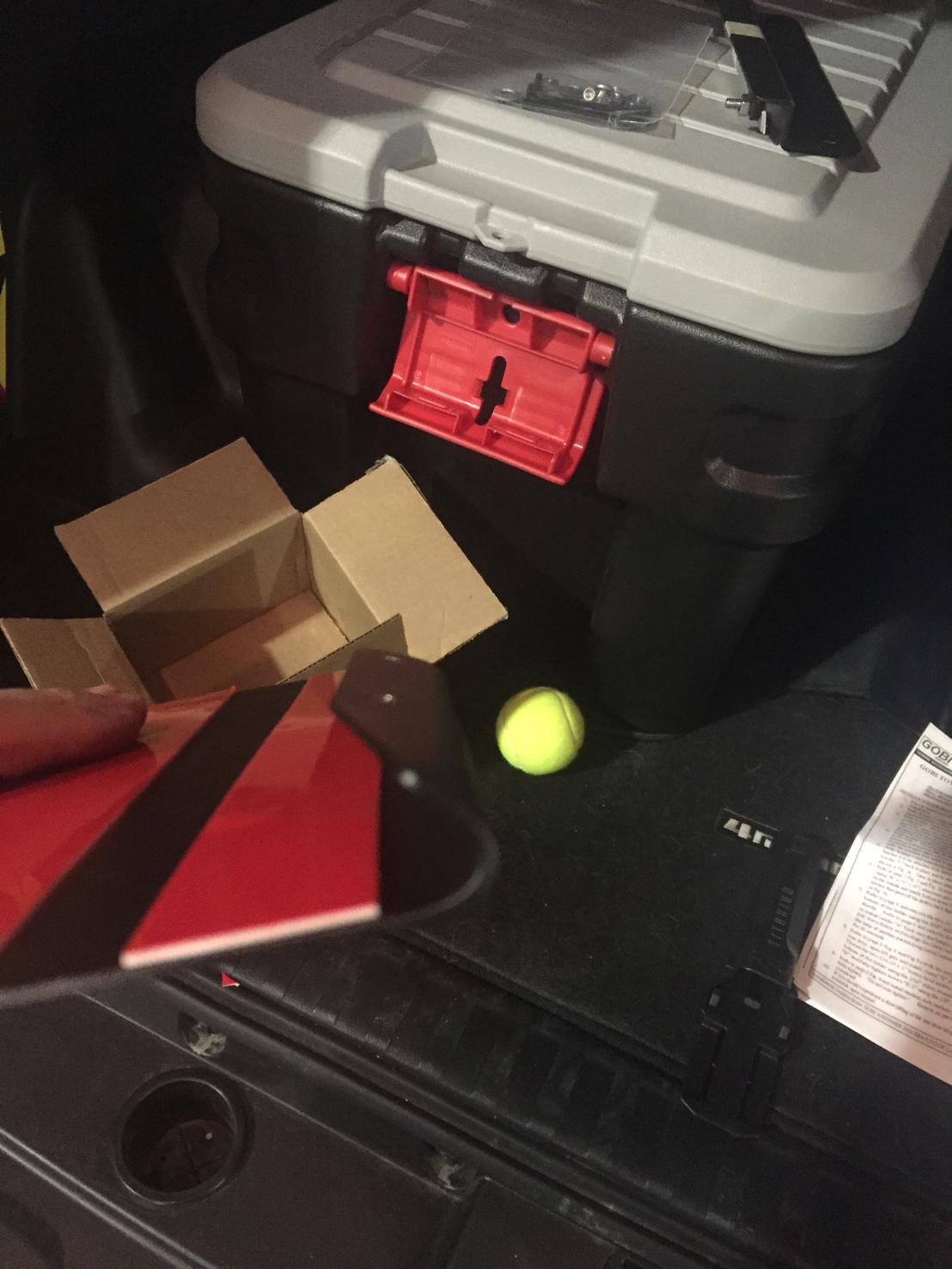

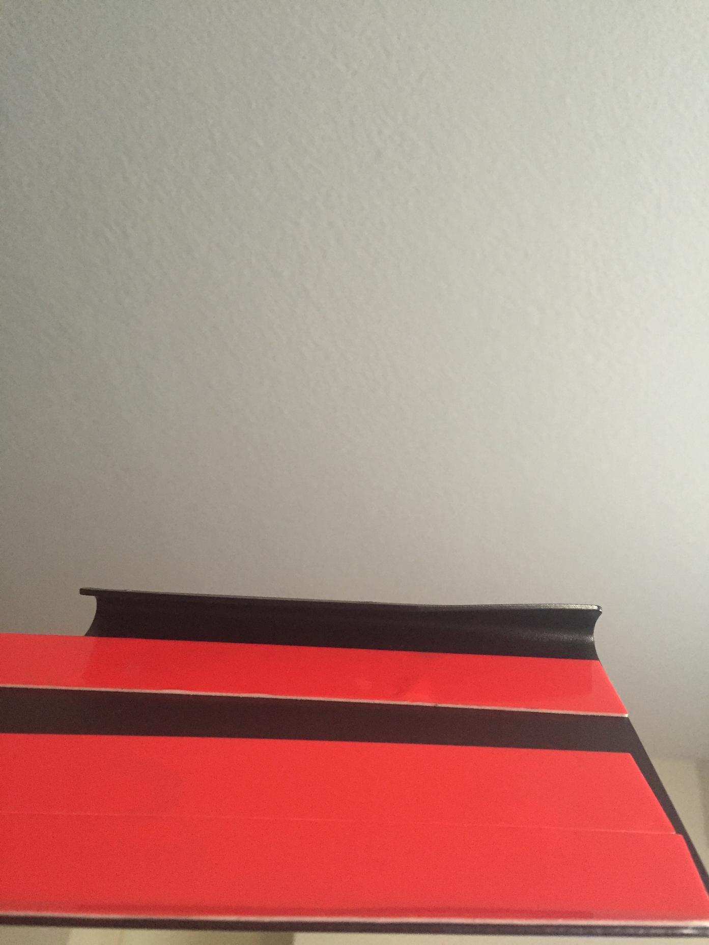

Gobi is closed and I was hoping to install the ladder tonight but I want to verify something with the top mounting plate because the instructions are not clear and I am having a hard time getting it into the body gap without doing paint damage. Is the curved part of the bracket supposed to be uniform or does it taper/angle change on one end? I thought the change would be to help get it installed but after a few minutes of fiddling I figured I would ask here to make sure my bracket didn't get bent (unlikely with how it was packed but just want to verify)
To clarify, the taper is clearly supposed to be there from other installation pictures however I am unable to tell if the bend is supposed to be uniform, mine is not which may be not clear with my [MENTION=65614]Antman[/MENTION] style photos.
Edit: The 3rd photo shows best what I am talking about

It is supposed to be different, it allows for clearance of the liftgate hinge. When I walked out to look I couldn't see if it's exactly the same as yours but it's definitely different on that edge.
Edit: ok if I understand your edit, I went back out and yes the edge is consistent across on mine as best I can tell.
Thanks, I added a 3rd photo to help clarify but It may be possible I got a bent bracket. The powder coat is in fine shape so it likely happened before that and not during shipping. I am not rushed so I will just wait till tomorrow and call Gobi and see what they say.
Yeah maybe someone that put one on recently can chime in but based on what I see on mine it looks bent as my edge looks the same across. I vaguely remember when I tested it before install it would move and was hard to tell how it would line up, but following instructions it took me like 20 mins to install.

Thanks, I certainly can bend it back and be good to go. If the powder coat cracks just rattle can it but if they are willing to ship me a new bracket I will likely just wait.

I didn't give them much of a chance but after calling and e-mailing yesterday I decided it wasn't worth the time and just bent the bracket back into shape. While Gobi has not confirmed this was the problem, once I did that I was able to install it into the body gap and the ladder installation went smoothly.
Microfiber towel and 2 min with channel locks and it was good to go.......took me longer to call/write Gobi then to just fix it........lesson learned.
