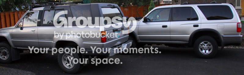

Here's a pic of my 1988 4runner and its replacement, our "new" 2000 4runner:
4runners.jpg~original
2000 4runner 4WD 5 speed 2.7L
Silver w/oak cloth interior
AC, PW, PDL, PM, tilt wheel, variable intermittent wipers, rear heat/AC, maplights, sunroof, 15" alloys BFG AT/KO 235/75R-15
