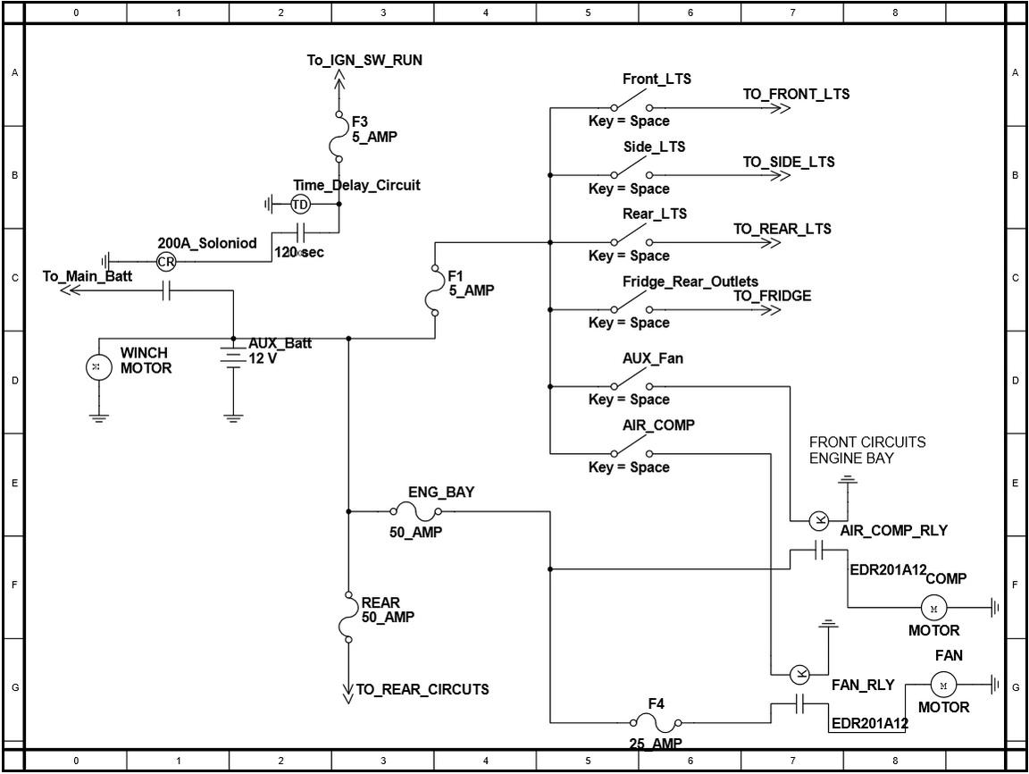

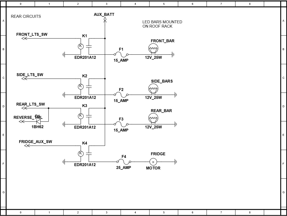

This coming summer I am going to Moab for a few weeks. In preparation, I am adding some electronics and lights as I will be dry camping the entire time. I have drawn up a wiring diagram with what I plan on adding. This is just some initial ideas of what I plan to add. I have bought the Light Bars I want to use. Black Friday deals rock!
I looked at a dual battery controller, but have decided to build my own that has a time delay instead of just having my auxiliary battery connect when I turn the key.
I would love to hear any thoughts on my design. It has been a while since I used Multisim, so sorry if it is a little messy.
I have split the diagram into front and rear.
