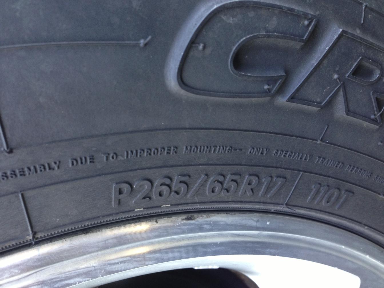

My new-to-me 4R came with stock wheels & new Nitto Crosstreks, 265/65/17. I'm close to ordering the Toytec Ultimate Lift. Of course, I'll need/want bigger A/T rubber, too. Can't decide on tires, nor wheels, but I do mostly street driving. Don't plan on any real rock climbing nor crazy off road situations, just camping, exploring, etc. Feel free to throw some suggestions my way!

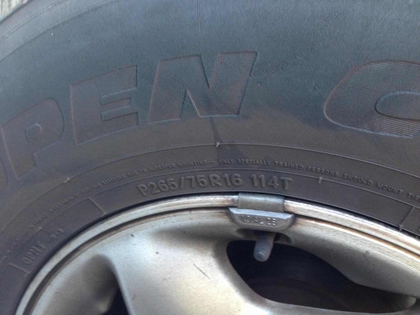

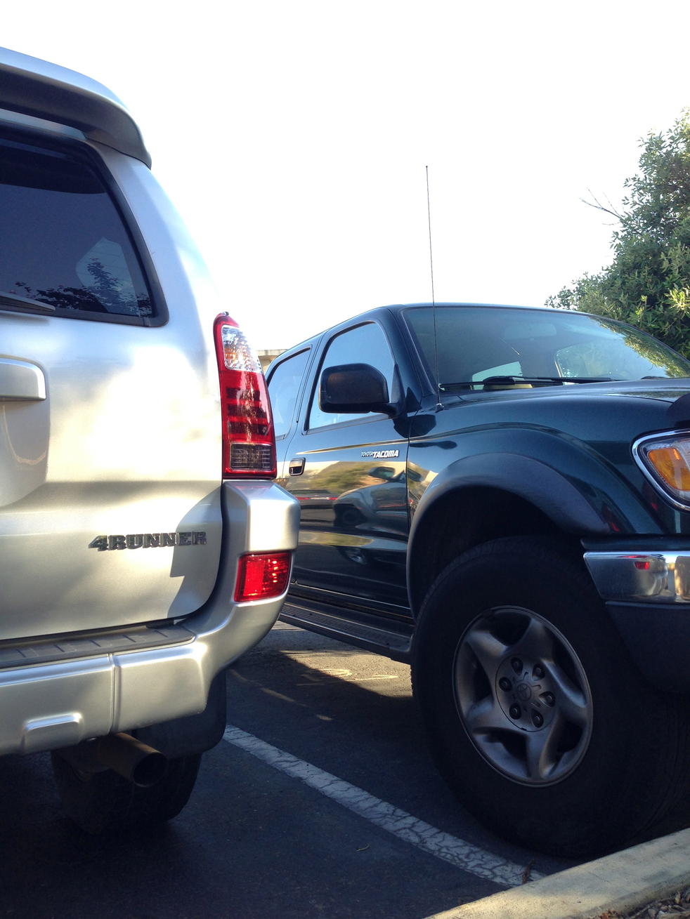

Just can't justify putting the Crosstreks aside since they're so new. But the other day, I was thinking about how dad's Tacoma needs new rubber. It's got Toyo Open Country 265/75/16 on now. So what about putting the 4R's wheel/tires on the Taco once I get a new setup? Will this work? Thoughts?

Your 4Runner wheels/tires should work fine on the Tacoma. What would you get for the 4Runner?

Most previous or new gen FJ, 4R, Taco 6 bolt rims and tire combo should work on our 4th gens. Just make sure to verify your brake caliper size as 13 calipers won't allow 16" rims to fit. Also some rims such as FJs 17x7.5 are 1/2 wider and push rim/tire out to line up with the finders more.

Pop's tires look dry rotted. I think that would be a good idea to make the swap. Last thing you want is his coming apart.
