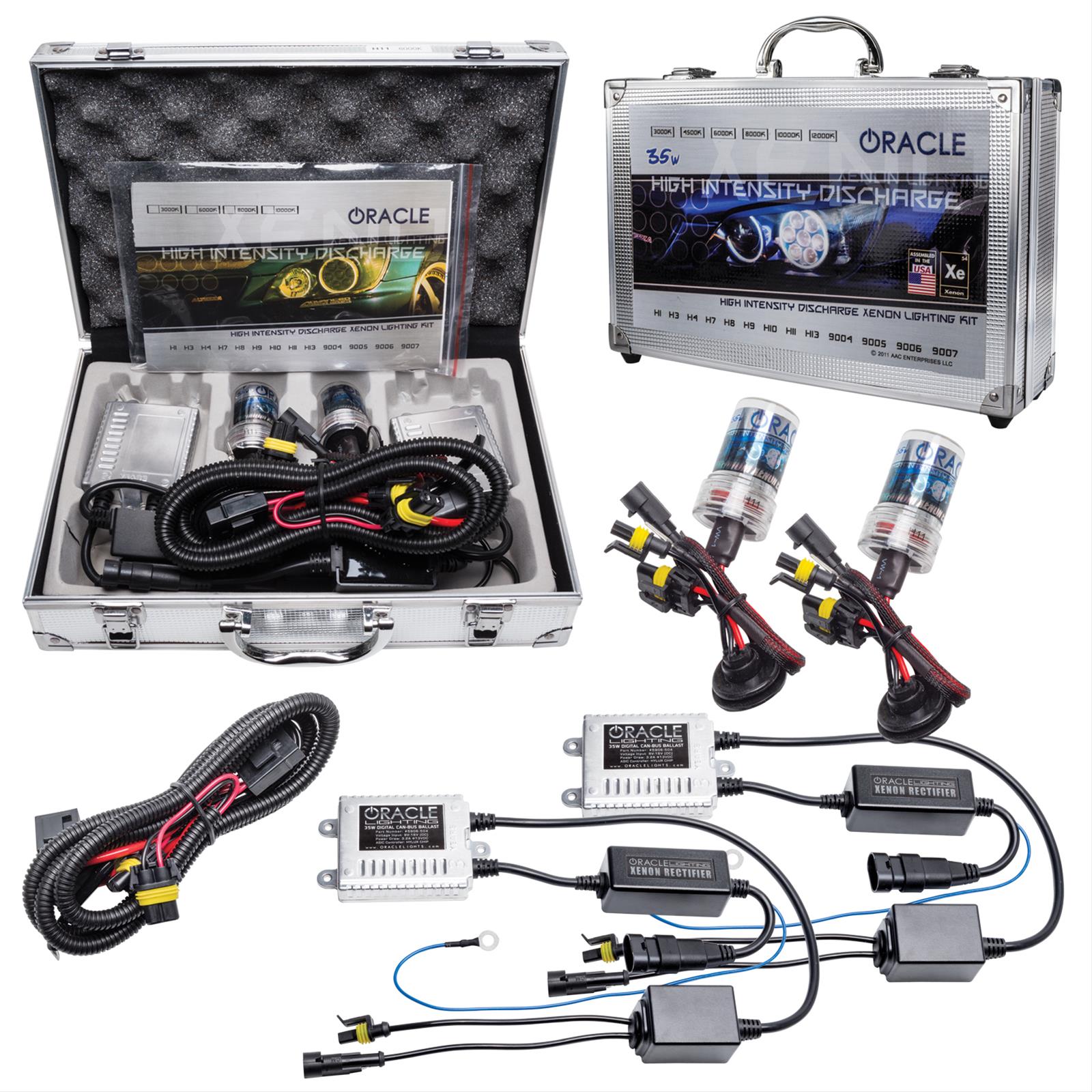

I went with Oracle Lighting's HID Xenon Bulb Kit 8126-013 - couldn't be any happier!
