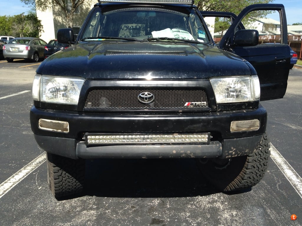

You could do what a couple of us have done before and put a light bar in the front bumper!
i hear those are super bright but I'm really looking for round lights, hopefully something with rock guards.

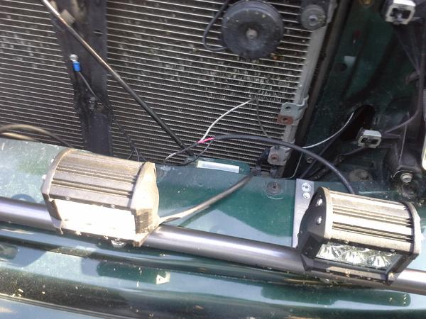

If you want a light bar you should look into this. Back when I still had my stock bumper I wanted to mount lights, but didn't want to drill some big ugly holes in my bumper so I made this thing for $16 bucks from parts I got from fleet farm lol.
It is made from:
2x Stanley L braces cut down to the first hole
1x 4 ft 1in aluminum tube
2x stainless steel bolts (holds tube to brackets
2x stainless acorn nuts
Its super cheap, super effective, and super cheap!

Looks pretty decent, might have to try that out. Thanks for the tip. Was it stable? Did the lights bounce around at all?
Ah, I get you.
there is a small amount of bounce, but nothing more than you would get with a bull bar, when I made this setup i was living in western MN and was running gravel washboard roads with no issues. And the lower you mount the tube on the L braces the less bounce there is and IMO the better it looks. :thumb3:
can't really tell from your photos, did you run a bolt through the pipe into the L-bracket to secure it? I can't see any bolt but can't think of any other way you could have secured the pipe to the bracket.
Ahh yeah, I added the bolt latter, because I started out with just a self tapper holding it. That doesn't work by the way lol. I can take some pictures of it when I get down to my shop on saturday, but I dont think I have any pics of it with the thru bolt setup. You can look through my gallery but Im pretty sure I never uploaded any..
