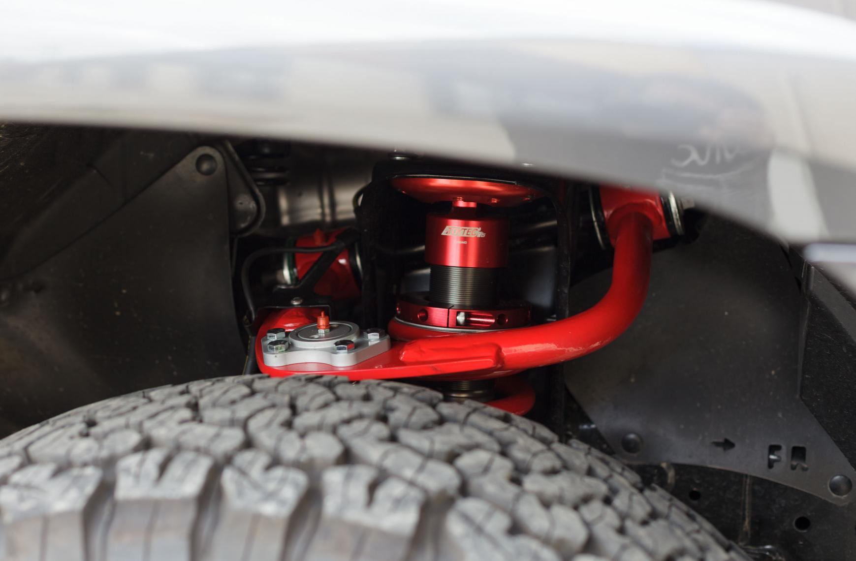

I really hafta agree with the JBA UCA's, they are solidly built, awesomely responsive customer service. I pair with the Toytec lifts, it's the preferred setup I install. I also like the way the red looks up in there.
I have the JBA's in mine. I had SPC's in a Tacoma a few years back and never cared for the way the ball joint mounted in them. Only had them about a year and sold the truck. I probably have 40k on the JBA's and no issues. Hit them with a grease gun every oil change and they are good to go. If I ever wipe out a ball joint it's a regular GM part I could easily get local.
