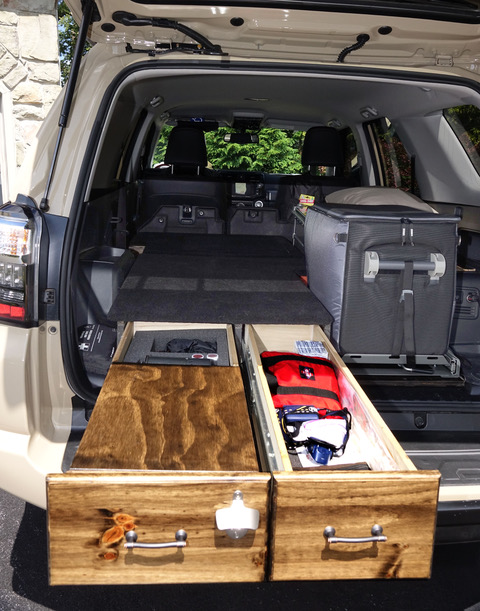

I mean if you want to talk cheap comfortable setups I got you. I removed the 60 side seat bottom (no third row). Then I took several iso mats and cut them and sandwiched them together matching the contour of the cargo hump. That fills the cargo area with comfortable sleeping surface for your torso. I shove an action packer in the 60 side footwell with the front pass seat slammed forward. I'm 6'5 and have more room then I need. It cost me 10 bucks for the two iso mats and like 20 for the action packer.
I'm ready for a permanent solution. I want the ability to use my truck as a pickup. Go camping, be the slob I'am, and just wipe out the back when I'm done. If I keep my current setup I'm going to eventually destroy the back seats which I could sell to recoup some losses from endless modifications. Rn my back seats are a cargo barrier and a waste of space.

One thing I will mention here is people bocking at the $1k price. For my platform and seat delete (not including the metal fab that the seat delete requires, done by another fabricator) the materials rack up to about $300-400, plus another $300-400 for line-x, plus my 14+ hours of labor. Long story short, if you don't cut corners (carpentry pun) you'll be at or above the GG asking price. Would I build my own again? Hell yes. But GG makes a really solid product that I have installed on another 4Runner and have been impressed.

And that's why I created my platform. Flush with the back seats, and a few more features :)

My plan is to have low profile (in line with the cargo floor) on the 60 split side. On the 40 split side I plan to build a drawer with a fridge slide on top. The single drawer paired with the underfloor storage where the 2nd row used to be should be plenty of storage. Any additional storage needs could easily be added after the fact.
