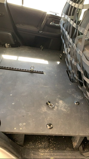

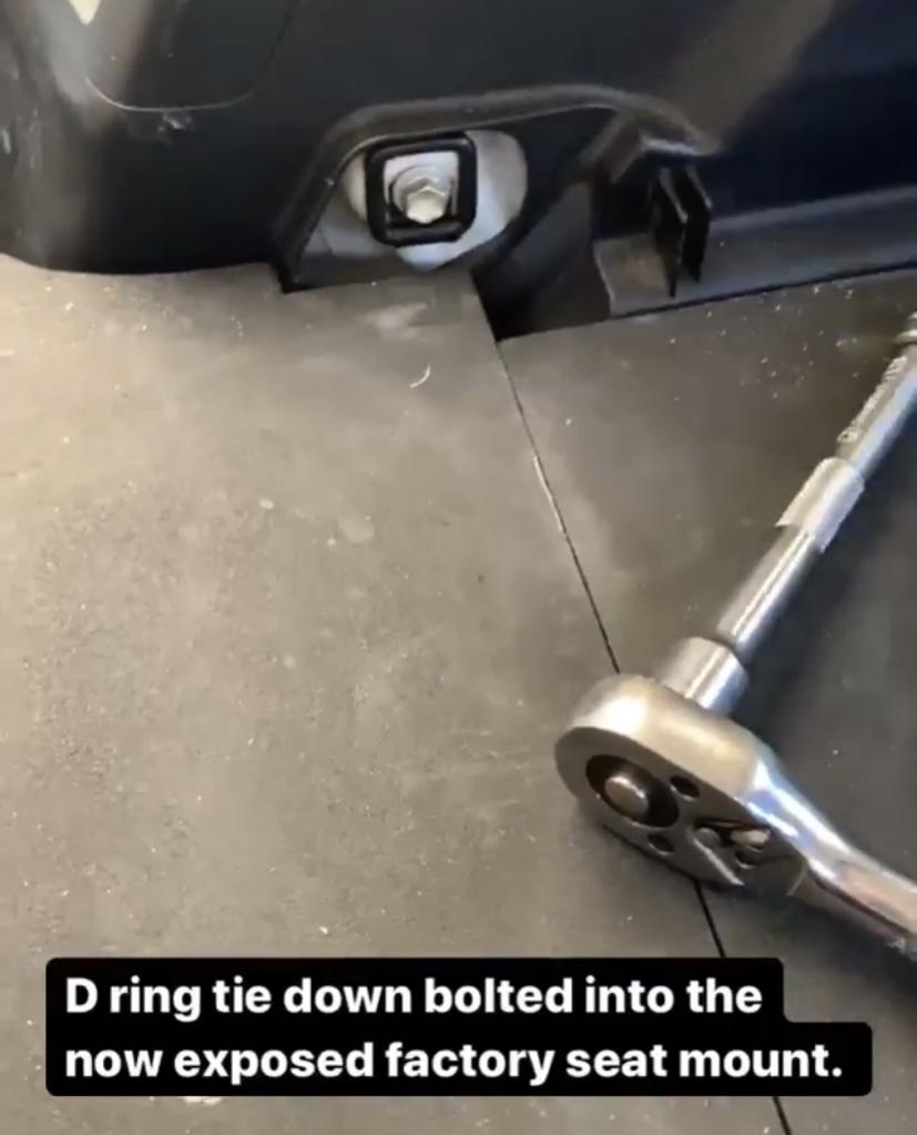

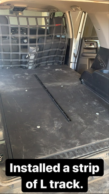

I really like the idea of the GG but I ended up going with the Boss Strong Box. I ordered it last week for 20% off and I really want the cargo space. I think I am going to build a frame of equal height that I'll use with the seats down to create the remainder of the platform for sleeping. My wife and I usually use a tent but she wanted a platform for some of her photography adventures. I just couldn't see spending so much $ for something that we wouldn't always use. The storage is something we will always use. I like the idea that the Strong Boxes are steel. Goose Gear looks awesome though.
Wrapped up my platform over the weekend.
Nice tie downs. I struggle with the stock d-ring cargo setup. Always wish I had more tie-downs
Thanks.
Camped in the truck for three years and usually had to re-strap everything once or twice on rough trails. Much more options now just need more straps.

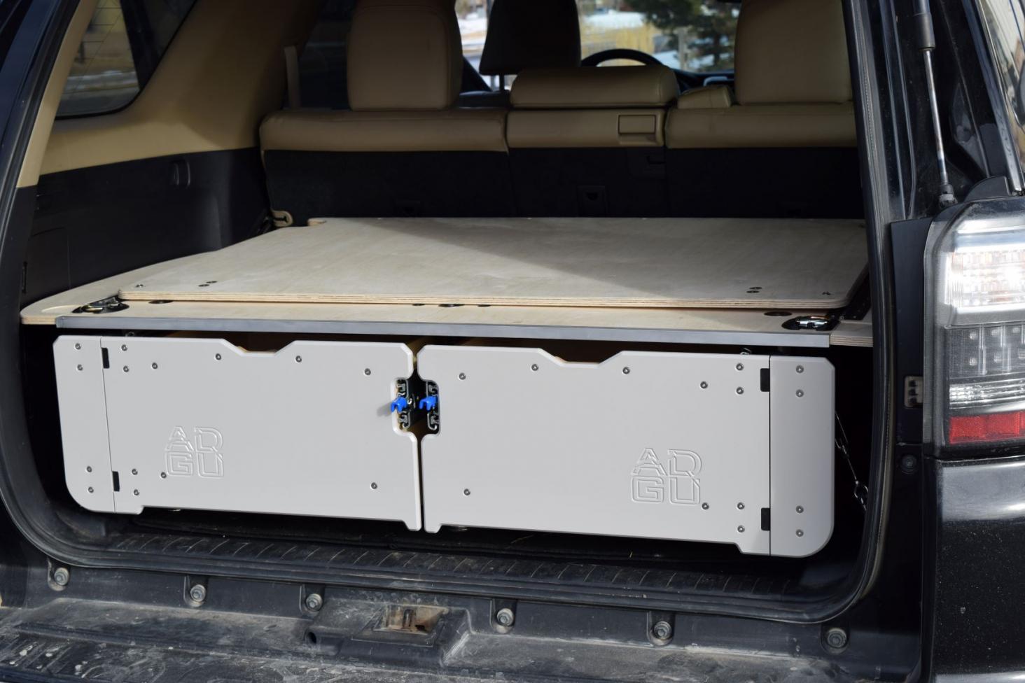

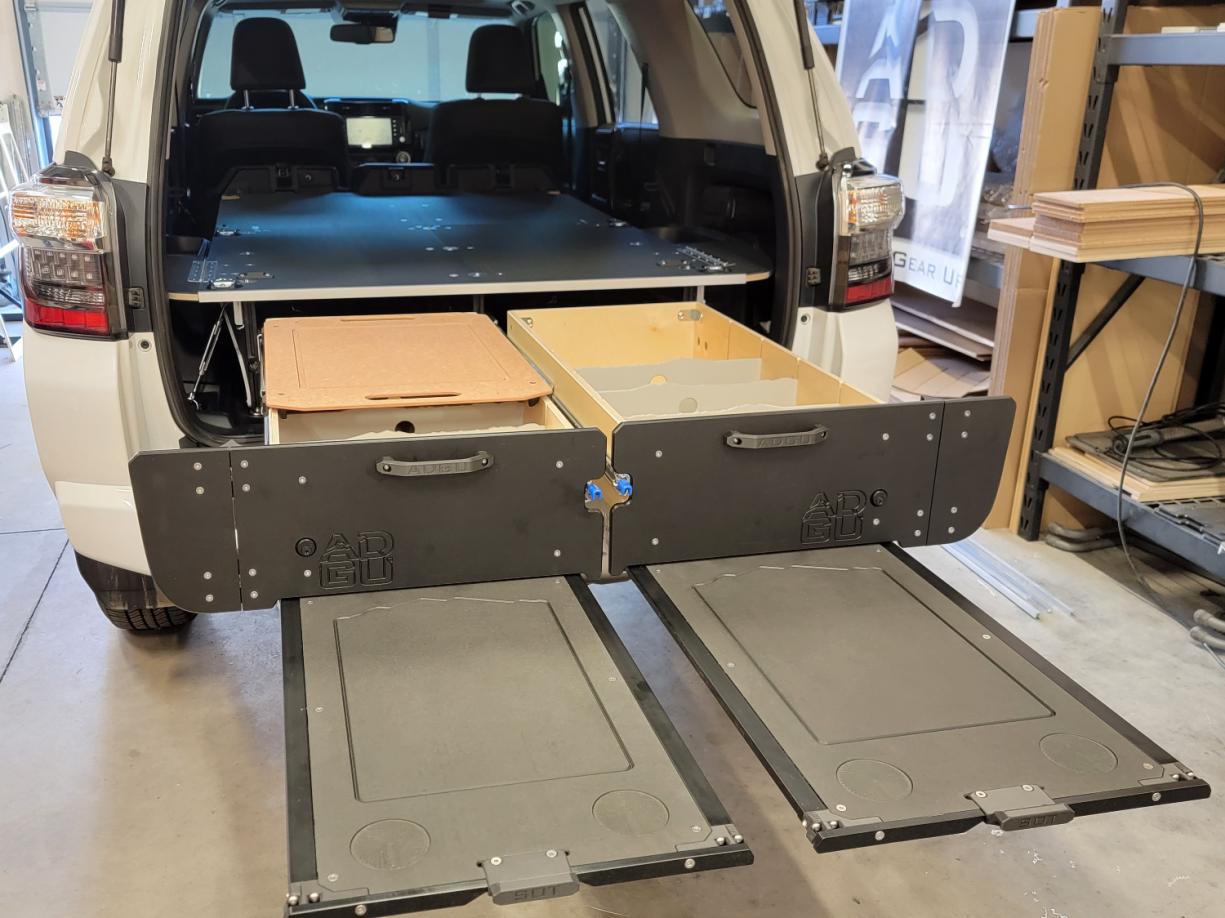

Happily! So this is a modular system that allows you to configure specifically what you want. Starting with a simple storage platform, adding drawers individually or together, the sleeper and the 'beauty panels' on the face of the drawer allows you to dial in the right functionality/spend for your application.
System bolts into the vehicle with absolutely no modification needed. Drawers are on ball bearing slides with a lock open/close mechanism.
The wings on the top/side provide access to a separate cargo area, providing a great place to stash the less-used gear that won't end up in a drawer.
THe main panels are made with a CNC, creating high precision finishes and allowing recessed hardware for a clean install.
The main panels are made with a CNC, creating high precision finishes and allowing recessed hardware for a clean install.

It looks like it should weigh less than goose gear, which I like, but isn't that similar pricing to goose gear if you buy during a sale?
That is correct! We also offer all of that bundled into what we call the 'Premier Package' which offers a bundle discount. With that taken into consideration, this will come in well below on the pricing. We just released the Beauty Panels on the 5G4R, so we haven't had the chance to update the website, but we'll have Premier Package pricing up soon.
This system is also pretty simple to install/remove, by far the easiest in that regard from what we've seen on the market.

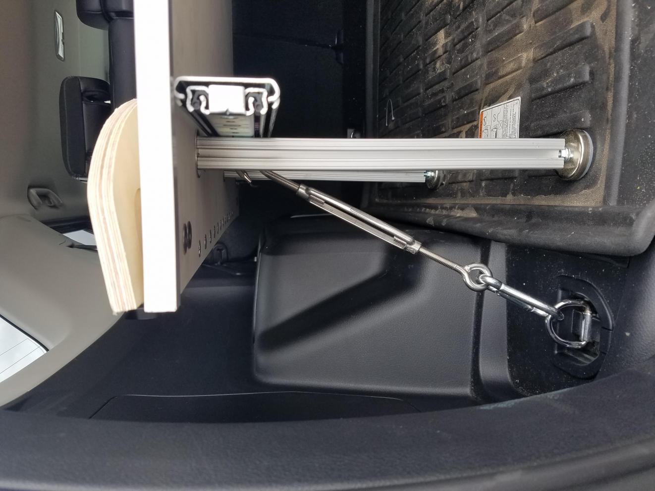

legs: these are extruded aluminum. Weight was a key consideration for us, we really wanted to minimize weight, so the light weight aluminum legs save considerably over wooden 'uprights'
attached: secured to the vehicle d-ring via turnbuckles. these are deliberately set at angles where they all 'oppose' each other, so when tightening them, everything locks into place. You can shake the vehicle by shaking the platform
sleeper: this is a pretty slick application for the 4runner. We originated in the landcruiser (am i allowed to use that word in this forum? haha) world and the landcruiser seats fold in such a way the sleeper just rested on top. For the 4runner, we had to create a structrual mechanism that allows the sleeper to sit on top of the platform when not in use, and extend and support the sleeper when in use.
I've attached a few pictures to clarify
