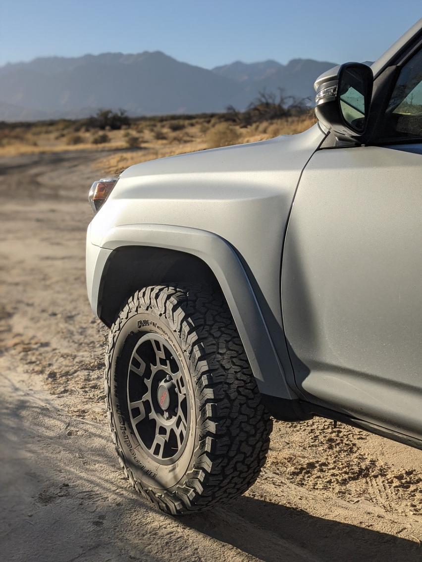

Got 285's put on last week...
TwistedJake
2" measured lift up front. 285-70-17 on 17x8 w/ -10 offset.
Trimmed the front bumper a touch, didn't move the liner at all. Pushed the mud flap back a touch. Only minimal rub on the flap hump at full lock.

Got the same lift specs on mine. I still think it's funny how at that lift with 33s it makes it look stock height again especially in pictures. Looking good !
Man that looks great, really makes me want to grab 285's. Nice to hear that you only had to do a small amount of wheel well management to clear most of the rubbing. I'm rocking -12 offset with my RRW wheels.

If you want to get rid of the rub on the mud flap hump there is an easy fix that I did. You can easily cut two vertical slits next to each other in the mud flap and zip tie it back to the hole in the body mount. This literally takes 5 minutes. I put up with slight rub forever at full lock and pulling in places, etc. until I did this. Makes all the difference being able to do whatever without any rubbing. If you need more explanation let me know and I can get some pics.

I need to do that, mind throwing up some pics?

Here you go! I got about 3/8" more clearance on each side by doing this!
Inside fender well!
Backside of mudflap at the body mount!
The amount of space I have now between tire and mudflap!
Doesn't rub in any direction now... onroad or off!

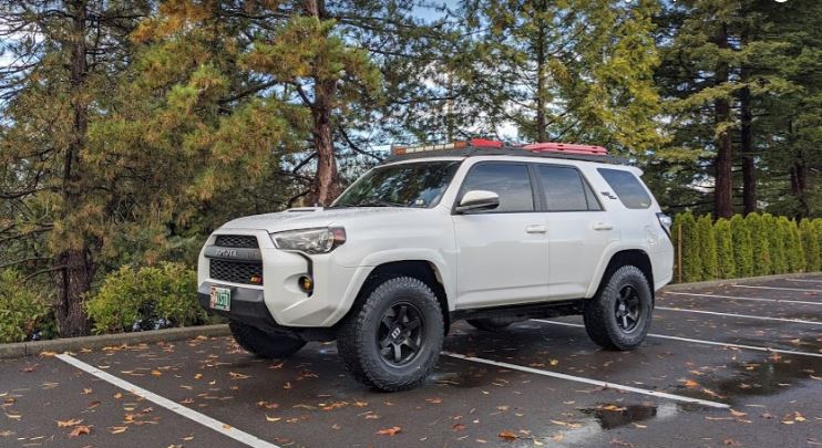

I had to pull in the front wheel well, trim the lower bumper and remove the front mudflaps to fix 285. Also used a heat gun to push back the fender at various spots I noticed rubbing after offroading. This was with stock suspension but now running 2 inch lift shown in pic. No body chop but it is close at full lock.
