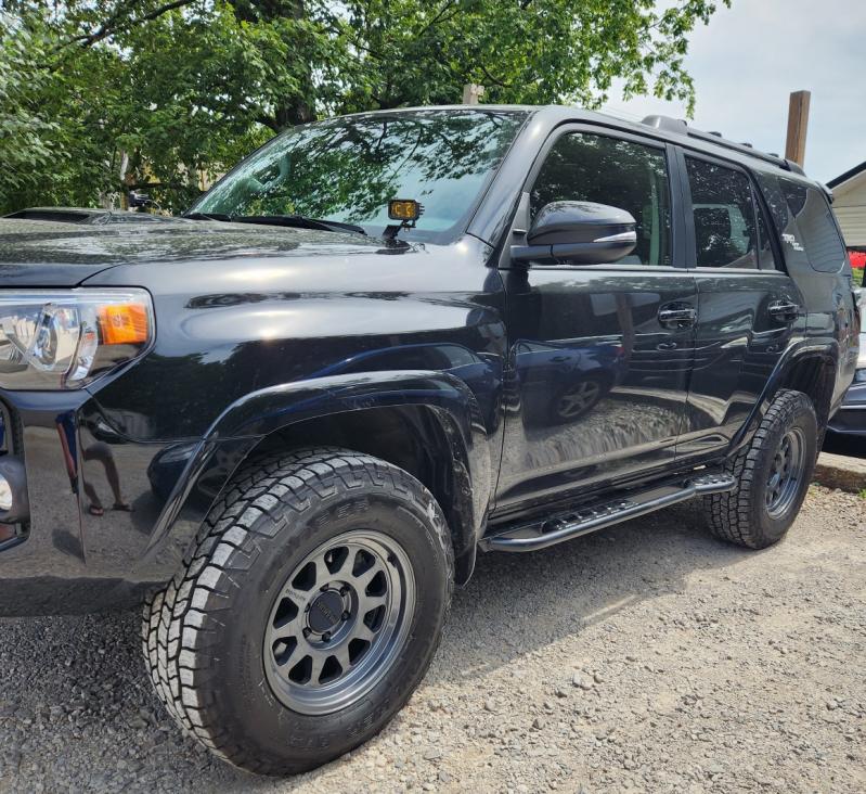

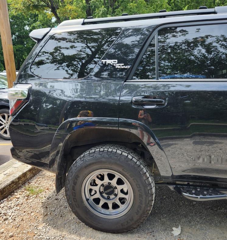

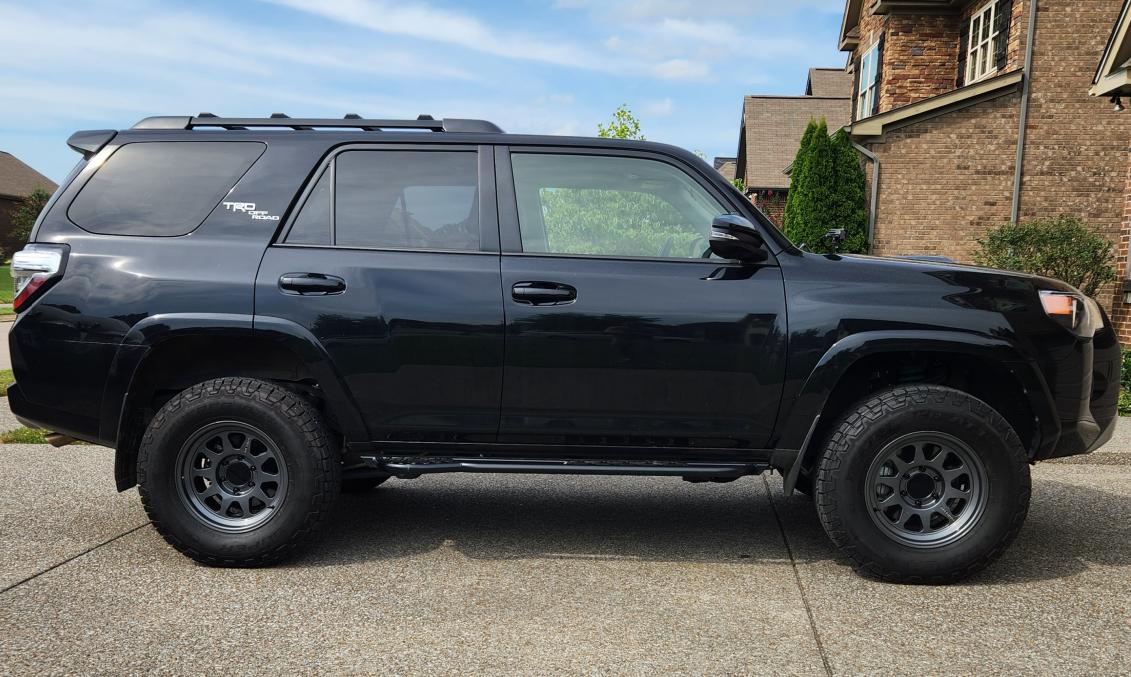

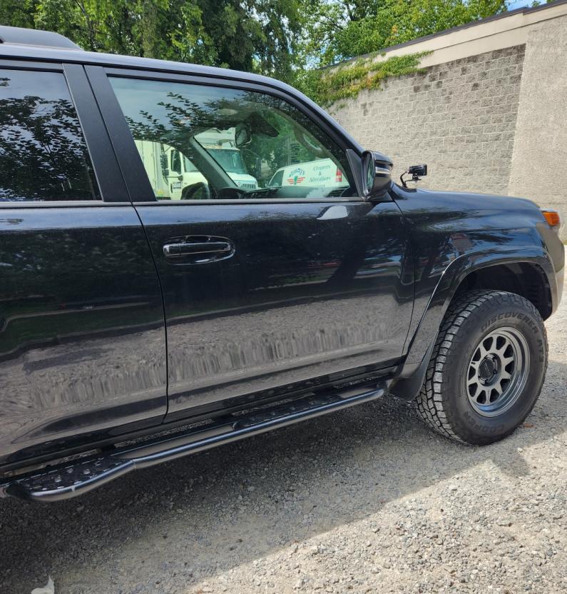

Just had some Method 316 17x8.5 +0 in gloss titanium mounted. Really like the color against my black ORP. 275/70 Cooper AT3 LTs were on my truck already but now rub at full lock in reverse due to offset on front left bumper. I do have a 2/1.5 Dobinson lift on as well. So I will need to trim slightly or at a minimum push the liner forward. I think eventually I'll step to 285 and it will look better but overall happy with the outcome.

I did after I took these pics. Trimmed the bumper cover and pushed the liner forward a bit. Plenty of space now.
Yeah, I agonized about cutting my 2016 to fit SCS wheels (rubbed like crazy with Falkens even in LT265/70R17 due to the offset). Then when I finally did it using a dremel I was like: "Hrm, what's the big deal?"
