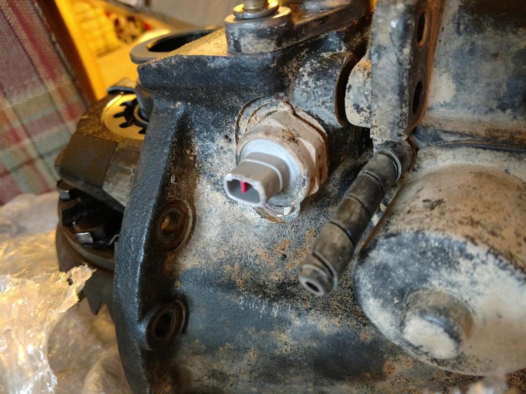

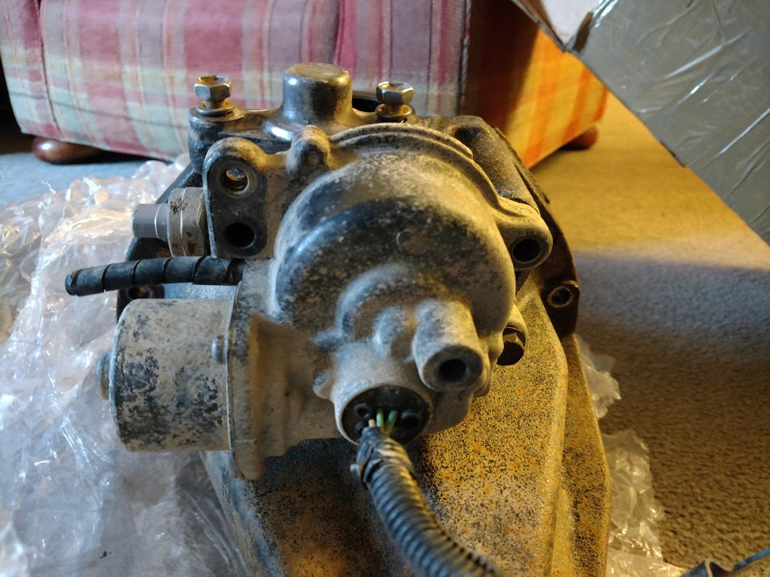

I just got my E-locker 3rd member today and was looking it over and it looks like I need 2 of the 3 bolts that hold the motor to the housing and then also the harness. The lower plug is there with wires coming out of it for like 6-7 inches into another plug but the upper plug is missing it's wires (see pics) where do I get the hardware for the motor and is this harness the correct one I need from LROR?
Toyota E-locker Wiring Harness
The pics are of the 3rd on its side with the motor up for orientation sake.

I don't know about that kit, but I've hard-wired my old 97 4Runner if you wanted to do that...if so let me know and I'll link the wiring diagram.
I am going to do custom wiring for mine. If that's what the diagram is for I'd be happy to look at it. PM it to me if it is for the custom wiring.
There's definitely a few ways to do it.
If you're doing custom wiring, you can skip the LROR harness and just get the one from Toyota. #82127-35100. From here you just need to splice into the wires and run those up to a switch of your choice, which it looks like [MENTION=65505]Kotrin[/MENTION] linked to.
Here's the one I used when I did mine: http://www.toyota-4runner.org/3rd-gen-t4rs/85197-ripcords-2002-4runner-sport-ed-48.html#post1199778
I can't find a PN for the bolts right now but I'm sure they're out there.

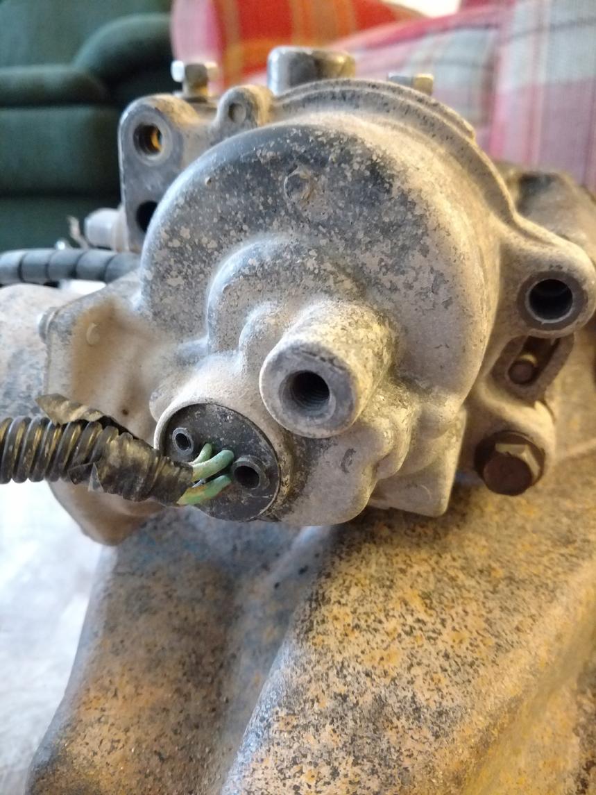

Those two holes I am thinking of I am pretty sure that's where the stud from the axle housing goes through.... But there are two other threaded holes that I am not sure what they are for. Especially the one on the front of the actuator that goes into it....

http://www.toyota-4runner.org/3rd-gen-t4rs/89502-how-diy-retrofit-elocker-wiring.html
Here is another build of what your doing, I'm trying to dig up the wiring diagram I used back in 2007, but this will cover everything you need. Once I find it i'll send it to you.
