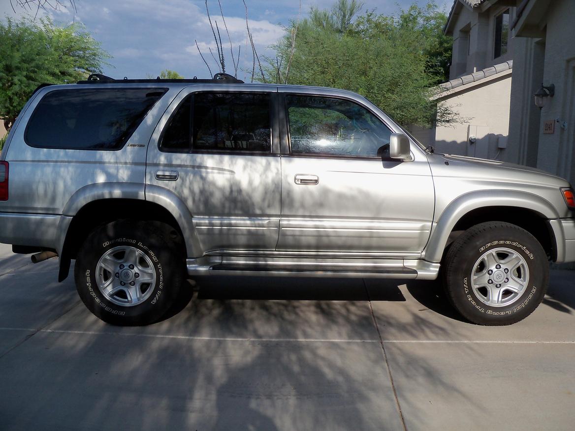

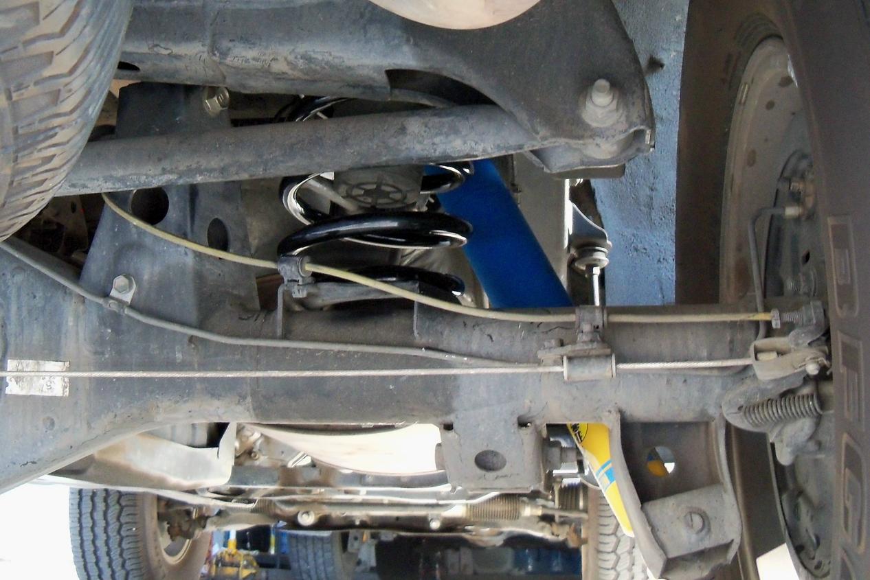

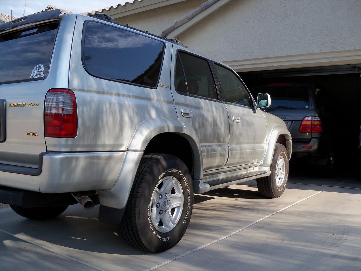

My son and I braved the 110 degree day here in Phoenix this morning and tackled the rear of his 99 4Runner Limited 4x4. A couple of weeks back I had stock replacement Moog 81041 coils and Pro-Comp ES3000's put on (garage did it), but although the ride was better it was still too soft. Ride height was about 1/4" higher than the original ride.
Anyway, took about 2hours with a floor jack and two 6-ton jack stands. Not too bad. Tricky part was getting the Moog's out - with the frame on jack stands and the floor jack on the rear diff, dropped the rear axle as far as we could before stretching the brake hose in the center. Then we used a bottle jack on the opposite side to drop the other side to pop the spring out. That was the cat's meow!
Going to try posting my first couple of pics here below...
Oh, rears went from 35 1/8" to just over 36 1/2" from floor to fender lip (thru center cap). BEST NEWS of all is no bottoming out on parking lot speed bumps now! :guitar3:

Forgot to mention credit to this link someone gave me on another post - I followed the Rear instructions which helped tremendously:
OME Suspension Install on 4Runner - Toyota 120 Platforms Forum
My buddy who has a 4gen 4runner found it and I wish I would have had that post when I did mine a couple of years ago. While it is an intuitive process, the visual aids would have helped.

Can you get the measurements for the center of the hub to the fender (the metal fender unde the flare)? I don't have the flares and I'd like to see where I'll be at if I install these.
The measurements you gave basically include the tire you have on at whatever PSI you're running, so the ground to fender measurement doesn't really apply to everyone's setup, whereas the hub to fender is universal for all as long as it's to the metal part of the fender.

Dezert4Runner - I'll take a set of measurements from the center hub both front and back...once it cools down below 105 degrees later this evening.
Ok - from the approx. center of the rear wheel hub to the metal fender (which is maybe 1/8" higher than the outer flare) is: 22 1/2"
Sweet! I'm measuring 20" rear pass side and 19 1/2" driver's side, so these would give me quite a bit with the worn out springs I've currently got. Thanks alot for the measurements.
