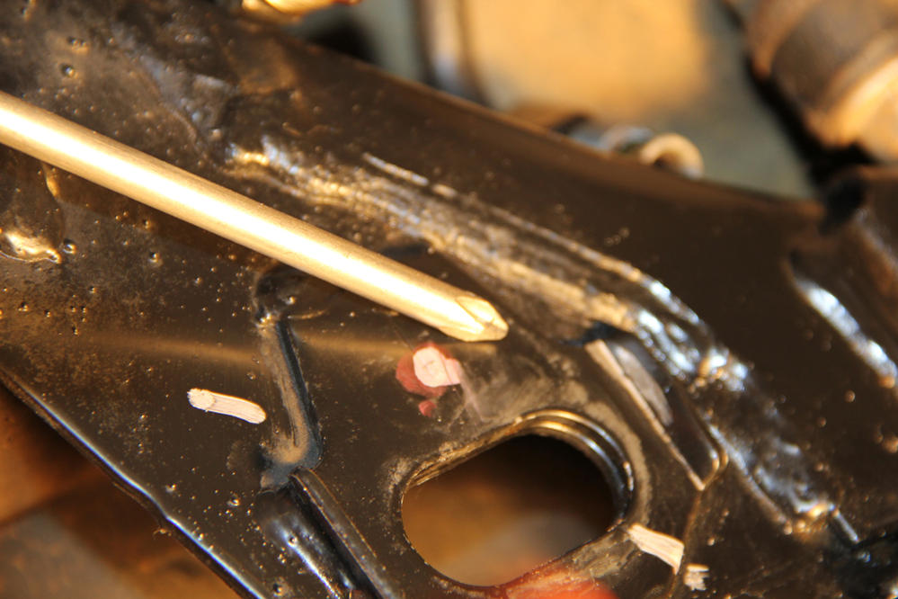

Pulled hard to the left before the alignment. Had the rig aligned but it was still rubbing the rear fender well. Everything looked great. Was able to finish our trip.
Fast forward to a few months later when I was finishing up one of my many projects, replacing my LCA bushings and found the rear alignment tab bent and the "bucket" that the LCA/bushing fit's into bent. Here'a few pics. Anyway, looks like the 5th gen has a similar LCA. They make stronger tabs for our LCA's.
Just an FYI if you don't detect anything obvious. This might not be an issue at all having been hit from the rear. Good Luck.
Notice the rear tab bent. Was able to adjust the alignment cam away from that tab.

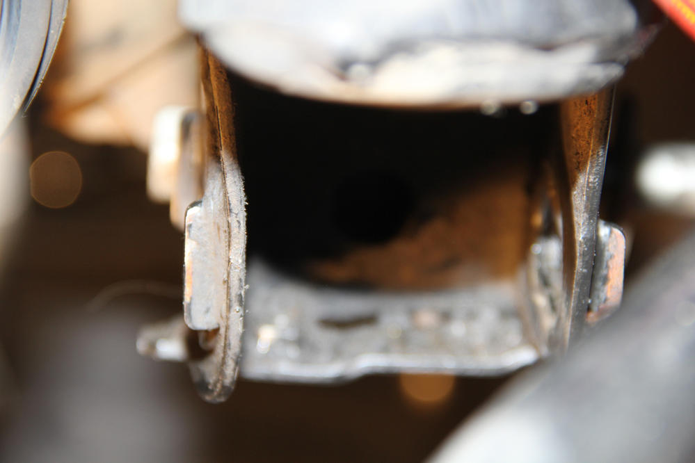

This may have some small affect but my alignment is good after all the front end work I did.
