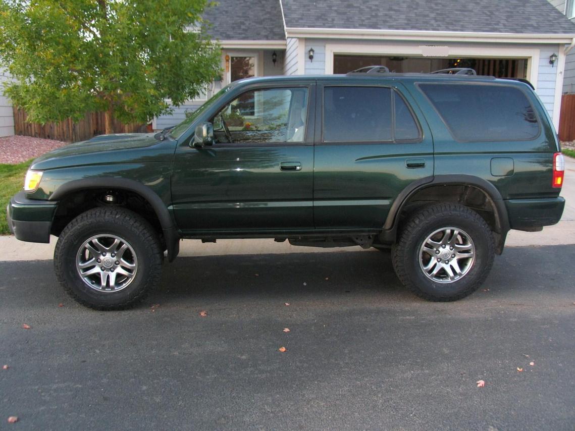

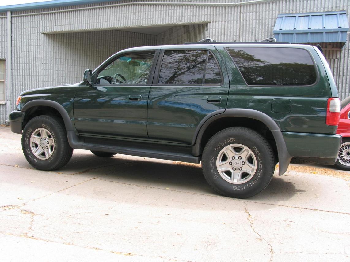

Here is before and after pics...Saturday, I put on the Toy-tec 3" front spacer (pain in the rear to compress front springs that far). OME 890 rear springs, open to suggestion on this but I think the back still needs a 1/2" or so..Thoughts? And also deleted the running boards and added factory mud flap. I was going to do the 3" OME kit but ended up buying Sequia 17" wheels off CraigsList. So budget in mind I am very happy how the suspension is, next spring I am going to add in the OME struts/ shocks or maybe Bilstien 5100 extendeds haven't decided yet. And to finish off the project got the Hankook 285/ 70 17's today.

No rub yet, though I have only 30 miles on them. There is 1/4" of clearance from the control arm at its closes spot (fully turned and truck jacked in the air) so should be okay.
