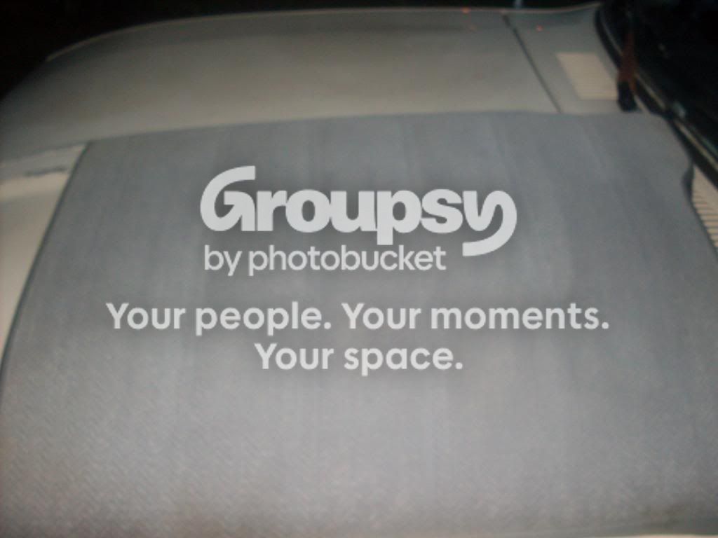

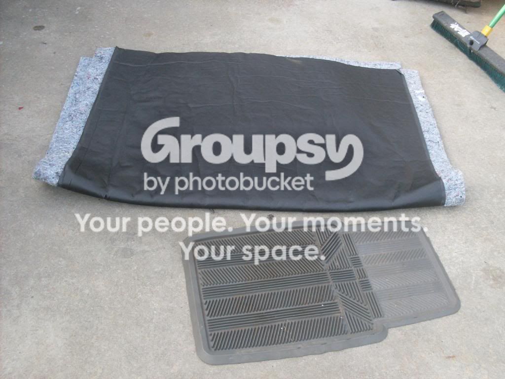

Here are some pictures of the carpet sound deadener from OC carpets. It is heavy. Added 50 bucks to my shipping cost to get this and an eva mat I will post up later.

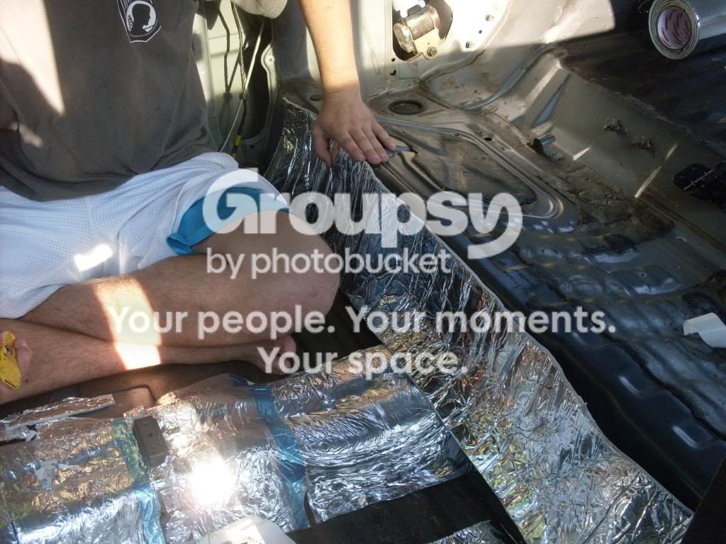

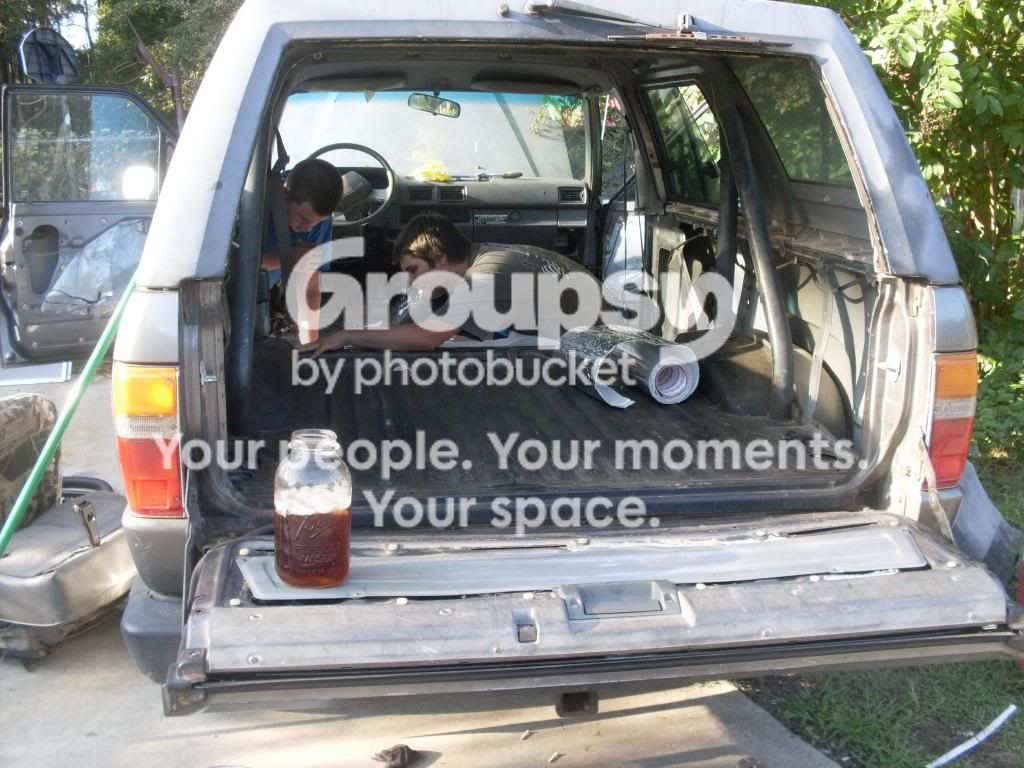

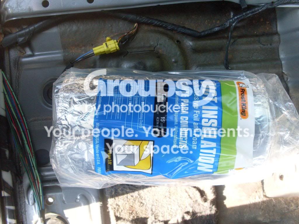

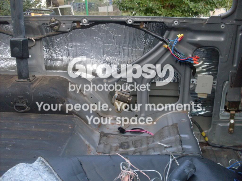

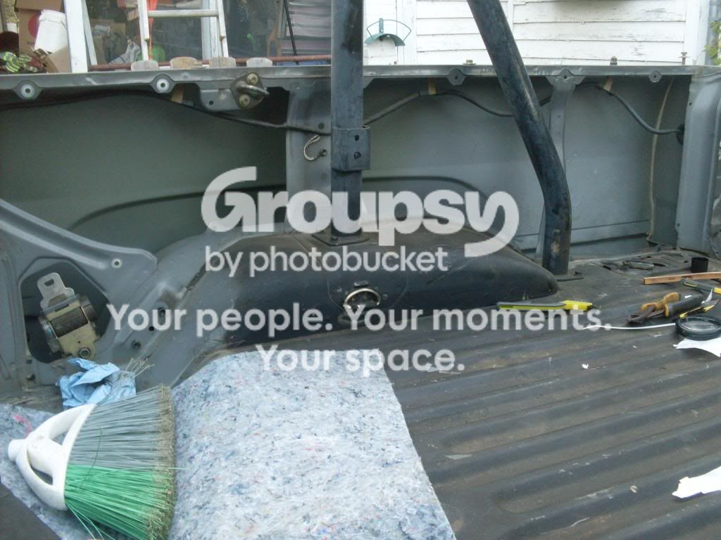

We pulled the top today. Makes it easier to work in the back. Weather is cooling a little in the southeast. Been a hot September. Bought the frost king plumbing wrap and used it for sound deader and insulation. Bought several rolls at Home cheapo and two today at Lowes. !8.77 both places. I think the Home cheapo had a peel off backing where the Lowes model did not. I will check the specs and update.

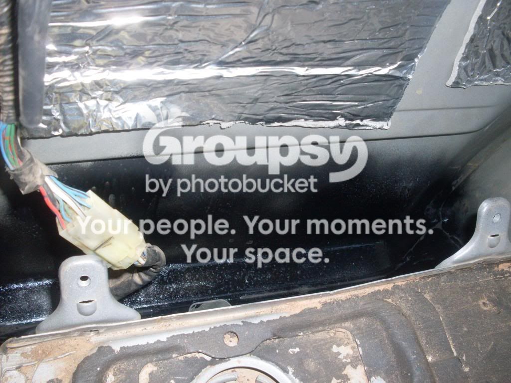

Although this runner appears rust free we shot a little rustoleom rust reformer paint in the holes in the back. Never spray silicone spray until you put a lot of thought into it. Ask me how I know!
Pic to fill the post.
That was Grayson and his friend. My daughter pitched in after a trip to the Dollar General for upholstery cleaner and cleaned the rear we had from the shop where we could ride three. It was kinda dark but the before and after is siginificant.

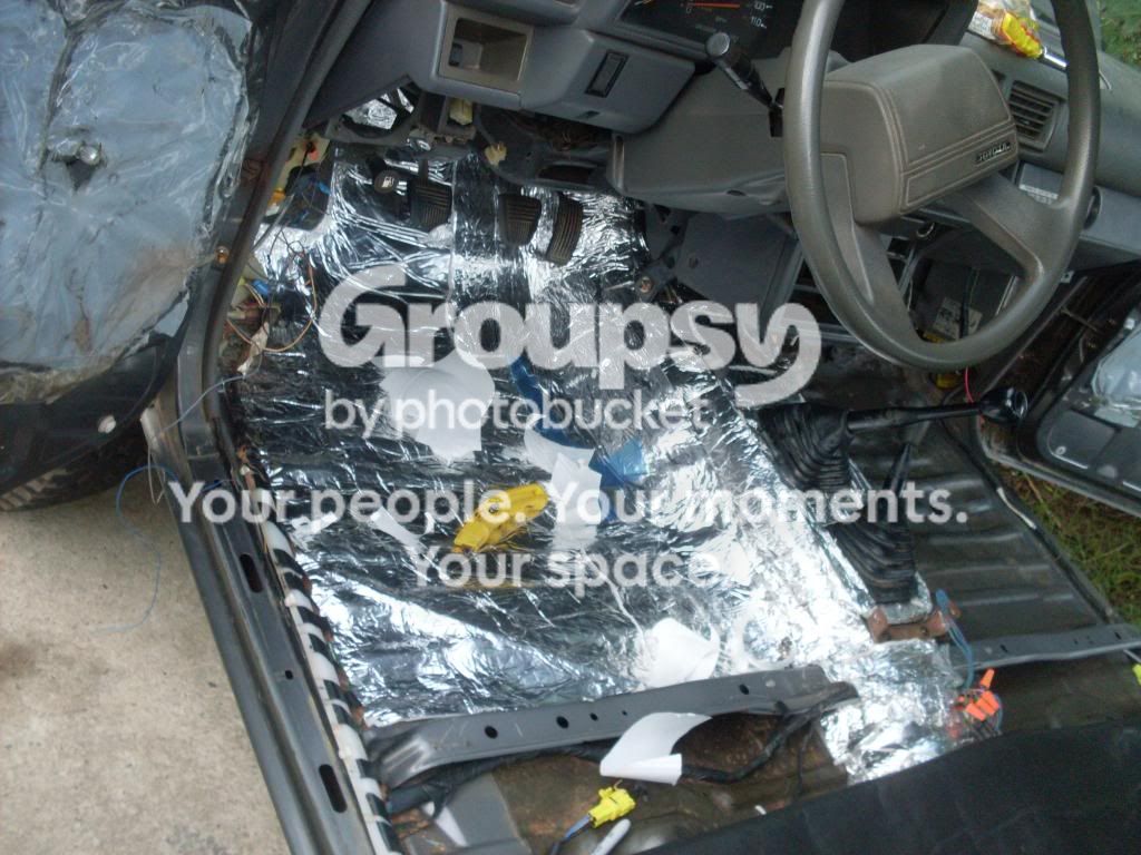

Here is a pic of the inside before we cleared the junk and started yesterday afternoon. Got the passenger SR5 seat cleaned and the base painted. Hope to get the new cable in tomorrow. The second set of RCA wires are supposed to be here from Amazon.

Ordered 3 sheets of the peel and stick from Mcmaster Carr today. Really nice to deal with and only 13 bucks to ship to me from Atlanta. Should arrive tomorrow. We are doing inside the doors with it.
McMaster-Carr

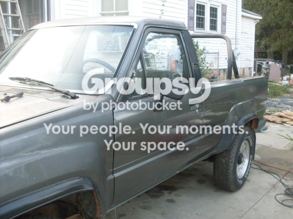

Getting back after it tomorrow. Planning on running 6 or 8 circuits to the back from the engine bay. Will loop them in the mid section in case I want to utilize some of them there. Here is a pic topless. Rain moving in tomorrow evening so have to clean out under the shed.

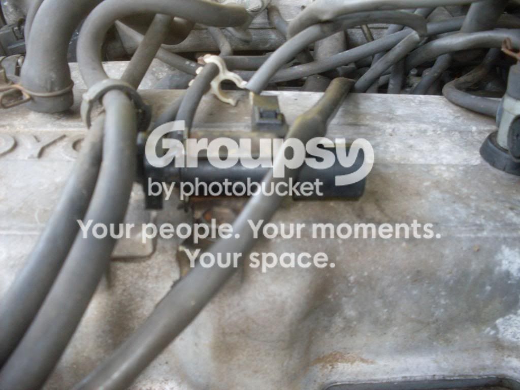

On another note this thing hisses on top of the valve cover. As they say in the vernacular "What up wit that?"

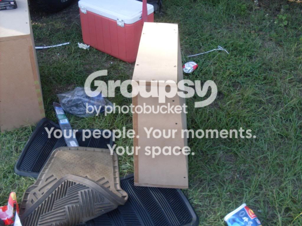

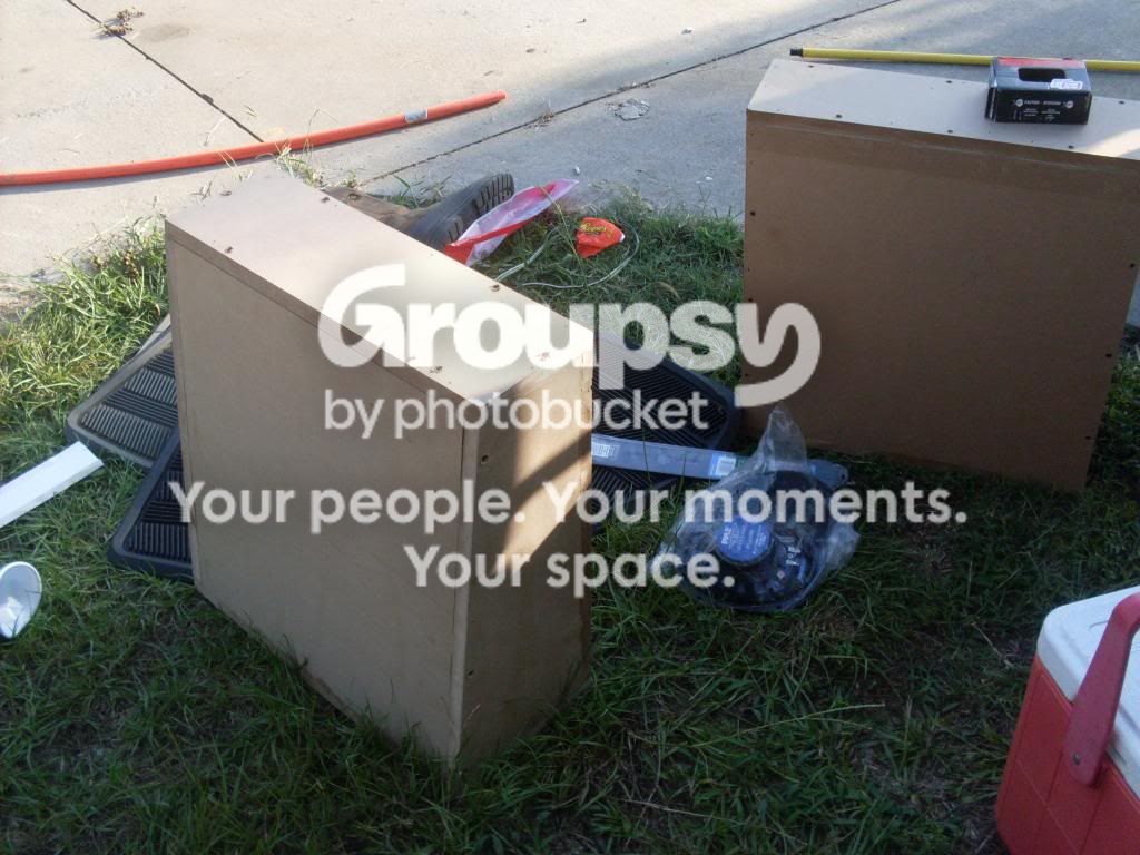

And finally here are the sub boxes we build the other night. I did not put enough design time into them combined with thinking out the interior areas of a 1st gen. They should work but in hindsight I could have been smarter.
Everyday I learn something is a good day!
This camera is a piece of crap but all I have. I guess I will start using my phone but the PB uploader app ADR. (ain't doin right) as my biology teacher says.

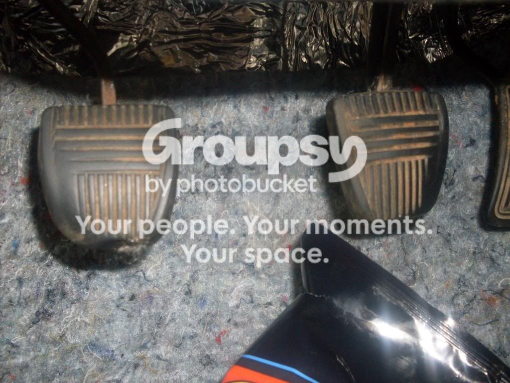

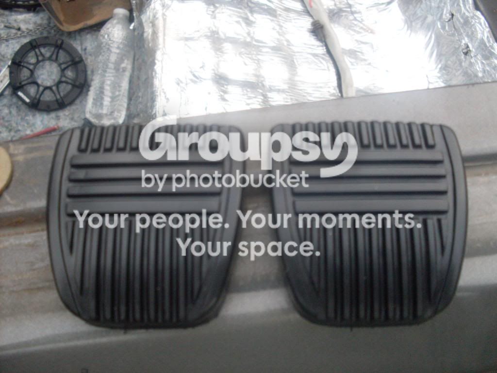

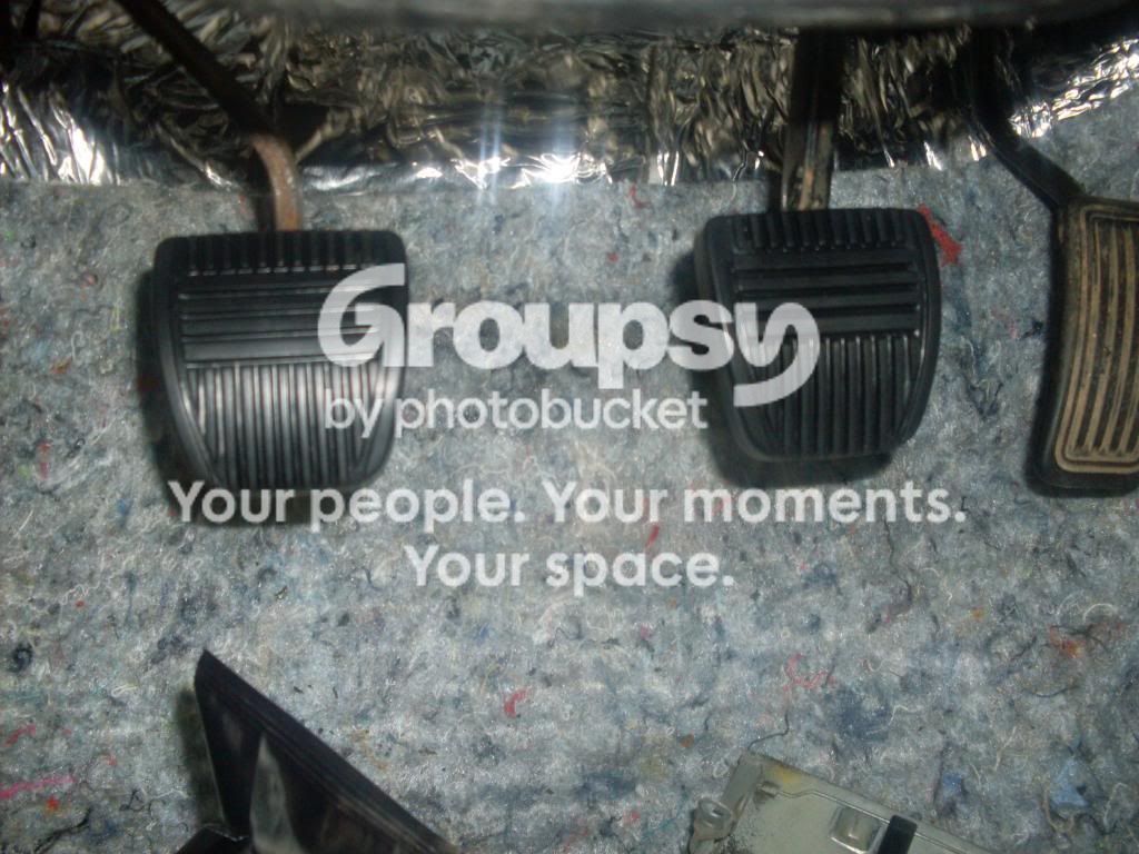

New foot rubber from the stealer, 3 or 4 bucks each.
Before:
After:

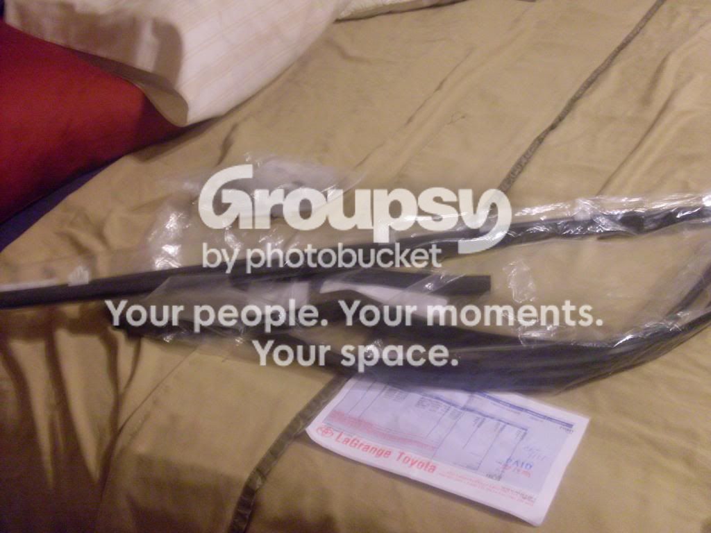

Stopped by my favorite stealer today and picked up some essentials.

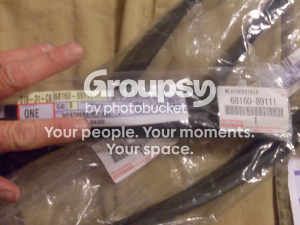

The door runner is specific to the wing window models. The vent window is essential to living in the Deep South.!
And the weatherstrip piece at the top of the door.

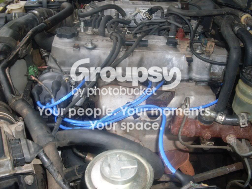

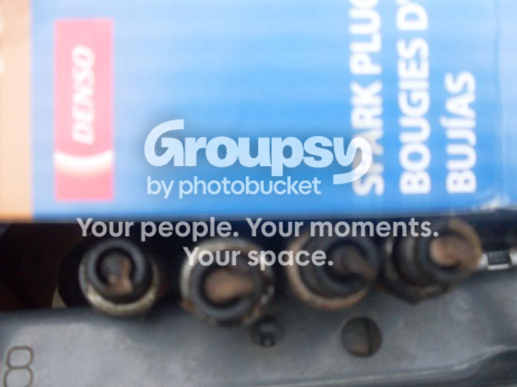

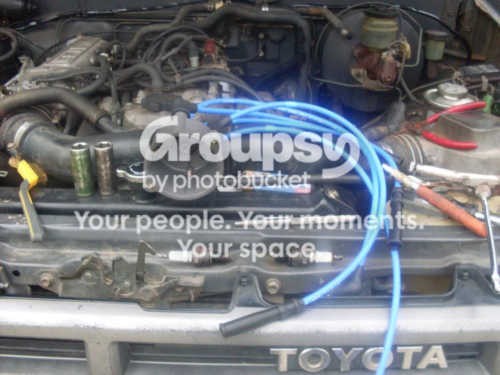

Plugs didn't look so hot. Runs better immediately.

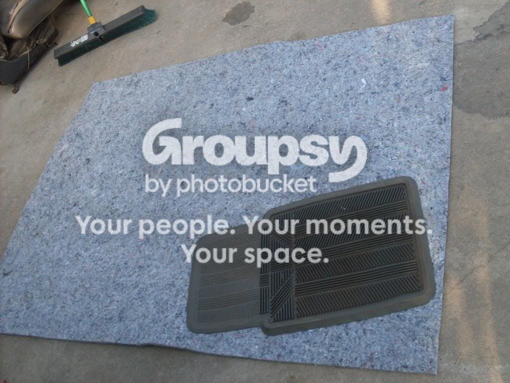

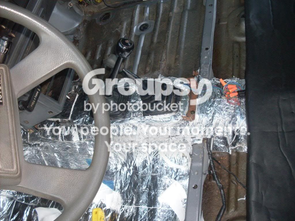

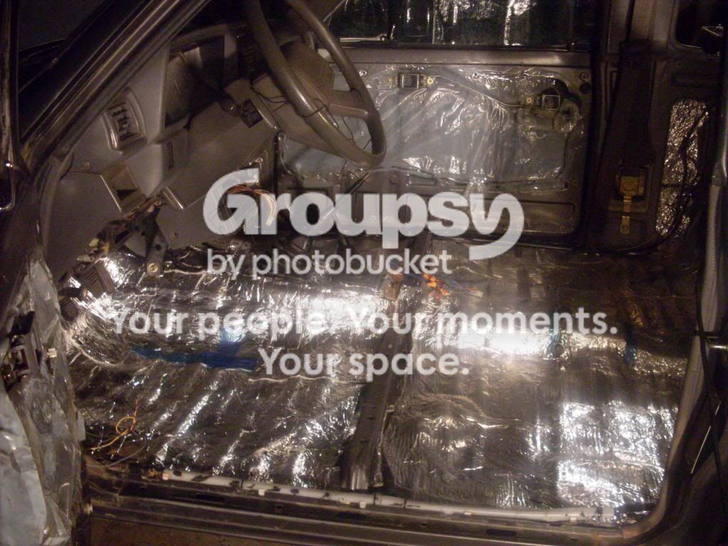

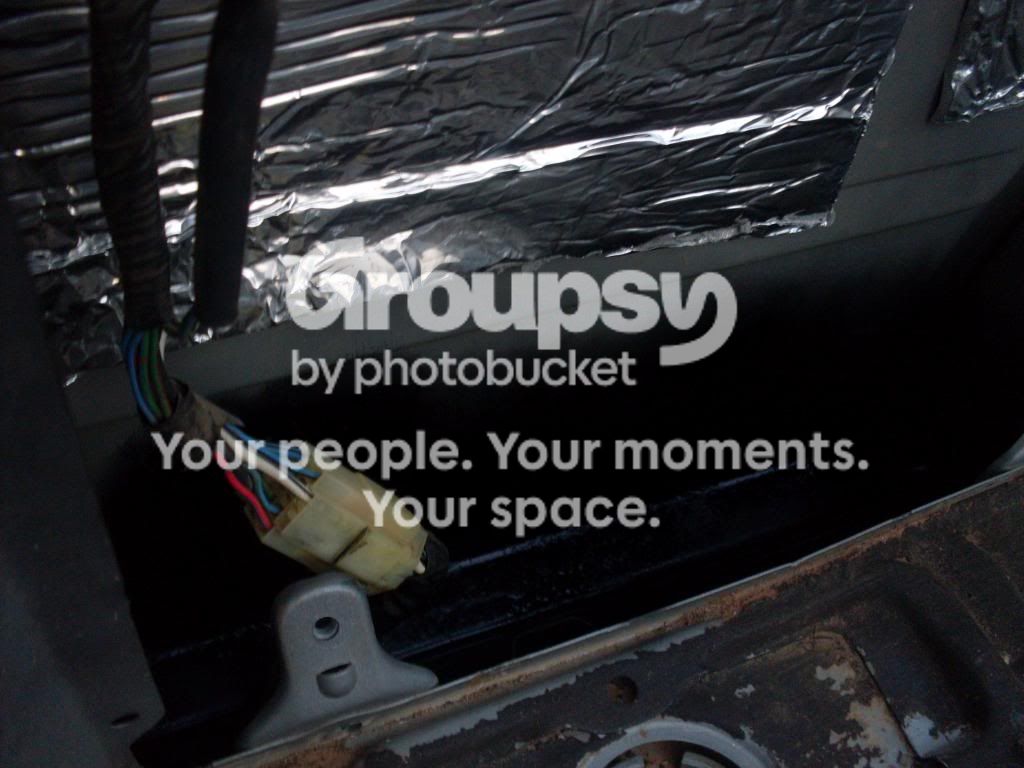

Got all the floor done before laying the underlay from OC. Hopefully this weekend we can get the amp mounted and complete the stereo, install the carpet and get the fronts in so we can have a no precipitation day driver. I think we used close to 6 rolls of the 12 inch x 15 inch duct wrap. Silicone hoses arrived yesterday and we started them. 70 bucks is a lot for 3 hoses. I was thinking you got all the little pieces on the firewall but I thought wrong. The clamps are awesome and heavy duty.
Think I took a few pics with my phone. Will go through the process...it is one..
A little more progress

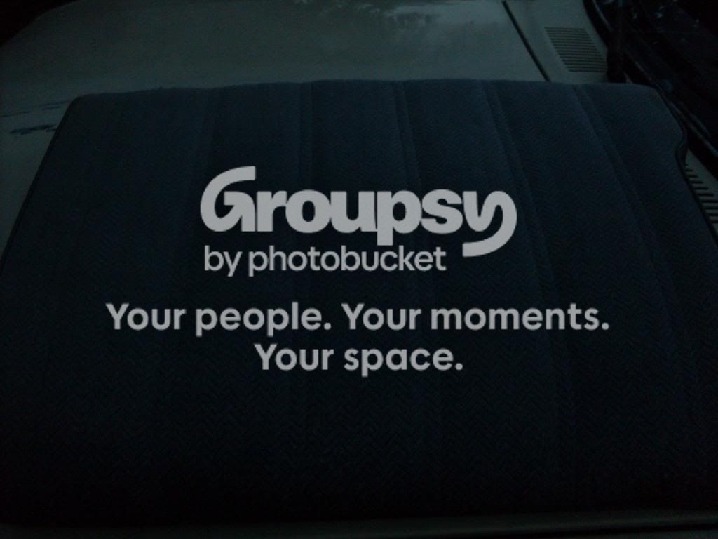

I slid cardboard under the wire to keep from painting the foam. Found a brush guard on CL last weekend. Nice and heavy for 80 bucks. Want to protect this ride from deer. They growem big down my way. I smashed a 99 Surburban a few years ago on a big one. Got all the front end including radiator and trans cooler. Ouch!:gun6: Have to take it apart and blast it and get it repainted. I am not crazy about the looks but function over beauty wins out. Got the front carpet laid, pics to come. Waiting on some additional speaker wire to wire for the rears and get the rear carpet in. I also have scraps of the carpet I ordered if anyone wants a swatch send me a SASE with two stamps and I'll send you a piece for color comparison. Its a little darker than the vinyl in this truck. My front seats were from an SR5 and I believe are darker than the rears. I'll post photos of it when it comes together. PM me for an address if you need the carpet swatch.
