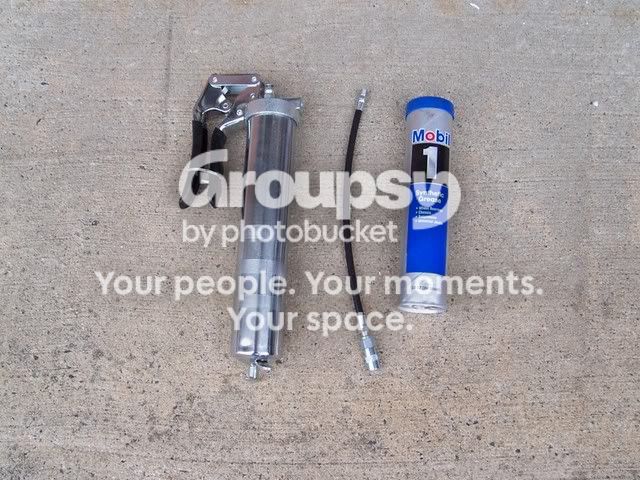

I have this one. I do not know where I got it from however. But buying the flexible hose is great to have.
greasegun-1.jpg~original
