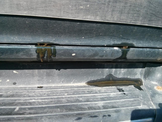

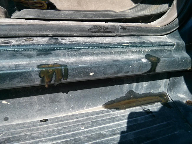

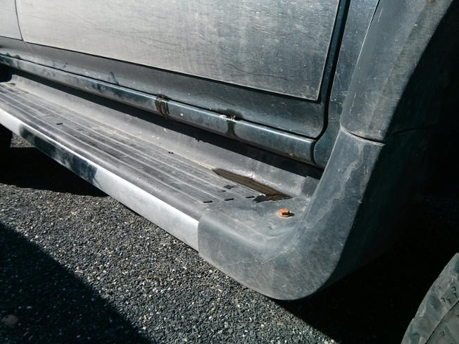

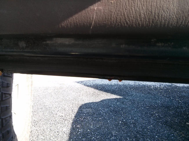

My girlfriend came home this morning after her night shift and found a bunch of grease/oil that had dripped from my door onto the door jam and running board. I had been tubing yesterday and our drunken friend had been sitting shotgun on the ride home. She had guessed that Jess had left something nasty in the door, but this is happening on all 4 doors, closest to the wheel wells.
Its a thick honey-like consistency petroleum product. I have no idea what it is because as far as I know there is nothing greased in the doors... Its been ~30oC (86oF for all you southerners ;) so I assume this is just grease melting... any Ideas what this from?!? I attached a few pics to make it easier to ID.

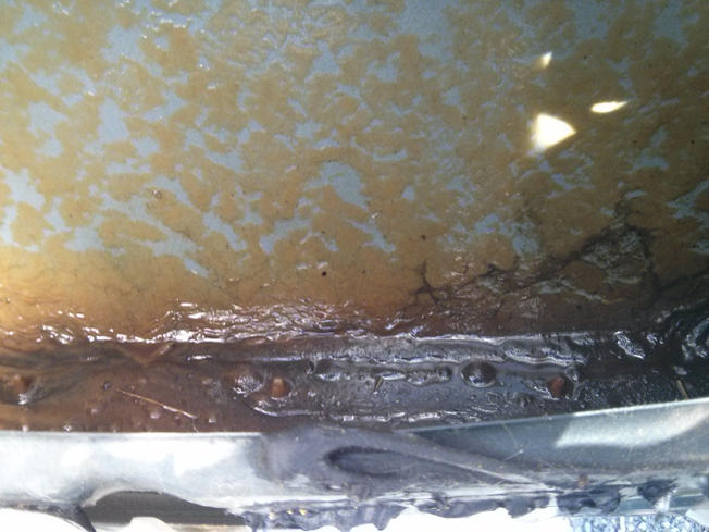

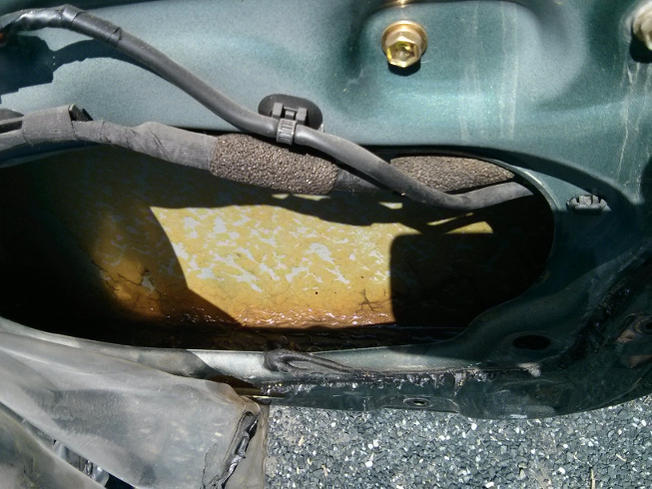

Rust proofing! That's what this is! But damn, there is A LOT of grease in there! It was an inch thick on the bottom. I opened up each door and scooped out many hand-fulls of the stuff. I didn't wipe it clean because I figured its better than rust... wow still surprised.
I attached a few pics for those who are interested. It looks like it was sprayed on fairly think all over the door, and over time it has all melted and pooled in the bottom of the door. There are two holes on the bottom of the door for drainage and that is where the oil is leaking out of. I feel like a product similar to bed liner would be a better idea for rust proofing... this stuff just makes a hell of a mess.
