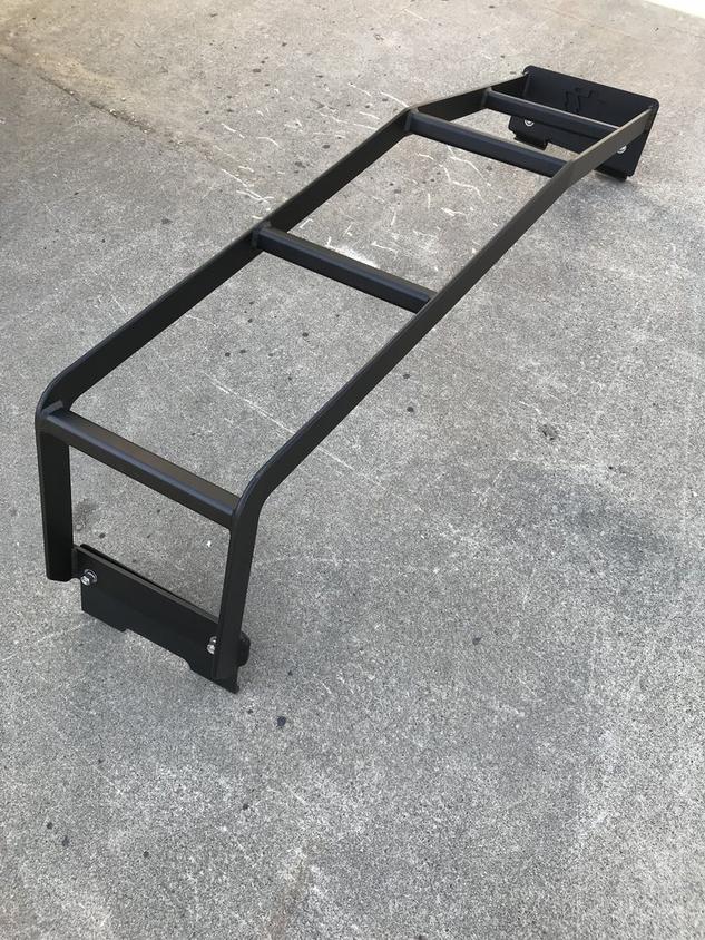

Green Lane Off Road Aluminum Ladder

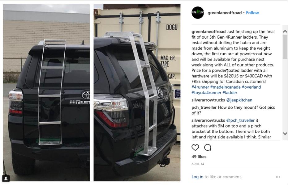

Yeah. Another forum member brought them to my attention, and I started my search just like you did. Looks like they are based in Canada, but just recently started shipping to the United States. I am looking at different ladder options. So, I may need to be guinea pig #1...
:ranger:
The sliders look great. Appears they have the inner square tube under the pinch weld for load transfer - how it should be done. It kinda surprises me how many manufacturers don't have a designer with any experience in sliders that knows how to design them properly. I wouldn't want them for rock crawling - aluminum doesn't slide very well... but for other offroad use they'd be great.
The ladder has a panel that glues on with 3M tape to the top of the door/spoiler, and looks like it bolts to the lower end of the door.

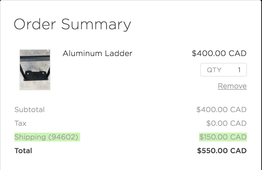

I happen to be in the market for a ladder but that shipping price is killing it for me
That is only around 430 USD after the exchange. 1$USD = 0.78CAD
For us Canadians it really hurts, high shipping and customs across the border and then add 30% to the cost of it all.

I'm interested in seeing more pics and reviews of this ladder. So far, this, C4, or Baja are on my short list. Love the idea of an aluminum ladder though.
I am as well. Might just have to buy it and be one of the firsts. I like the C4 because of the aluminum and lightweight, but its very boxy looking. This Green Lane ladder is sleek, without being too boxy like the C4. Style should still match my Prinsu rack nicely!
