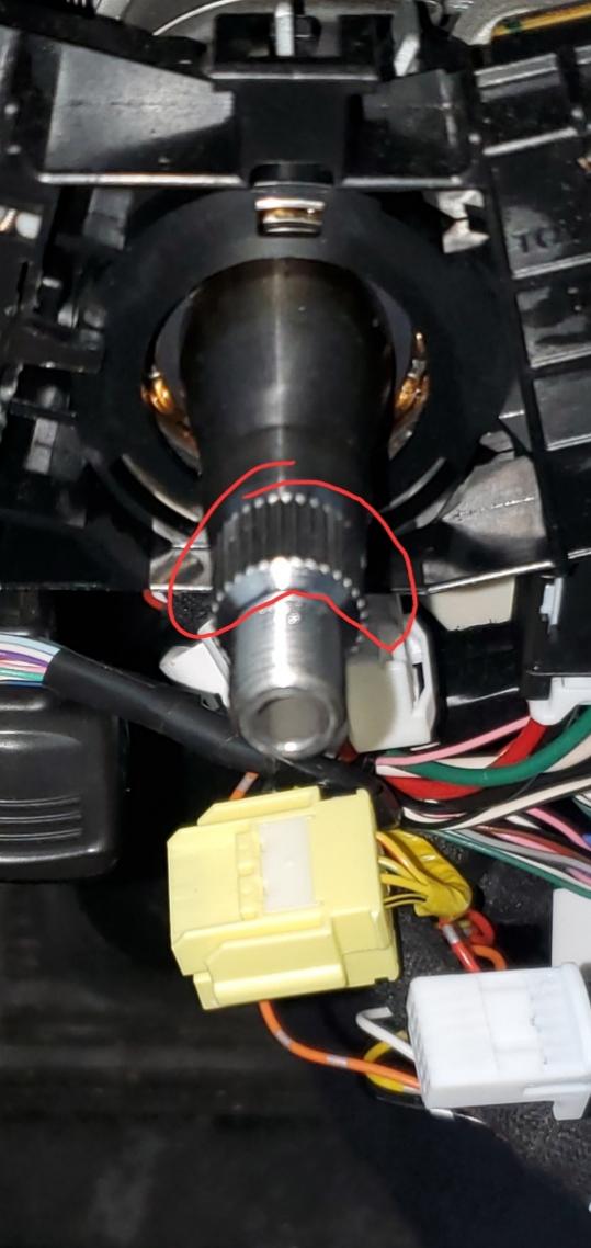

Just FYI. There are splines where the steering wheel attaches to the column/rack. If installed and you are off a spline to the right or left, your steering will be off. Pic for reference from when I removed my steering wheel. Hopefully the tech who did the re-install marked the splines accordingly so to re-install in the exact same way.
