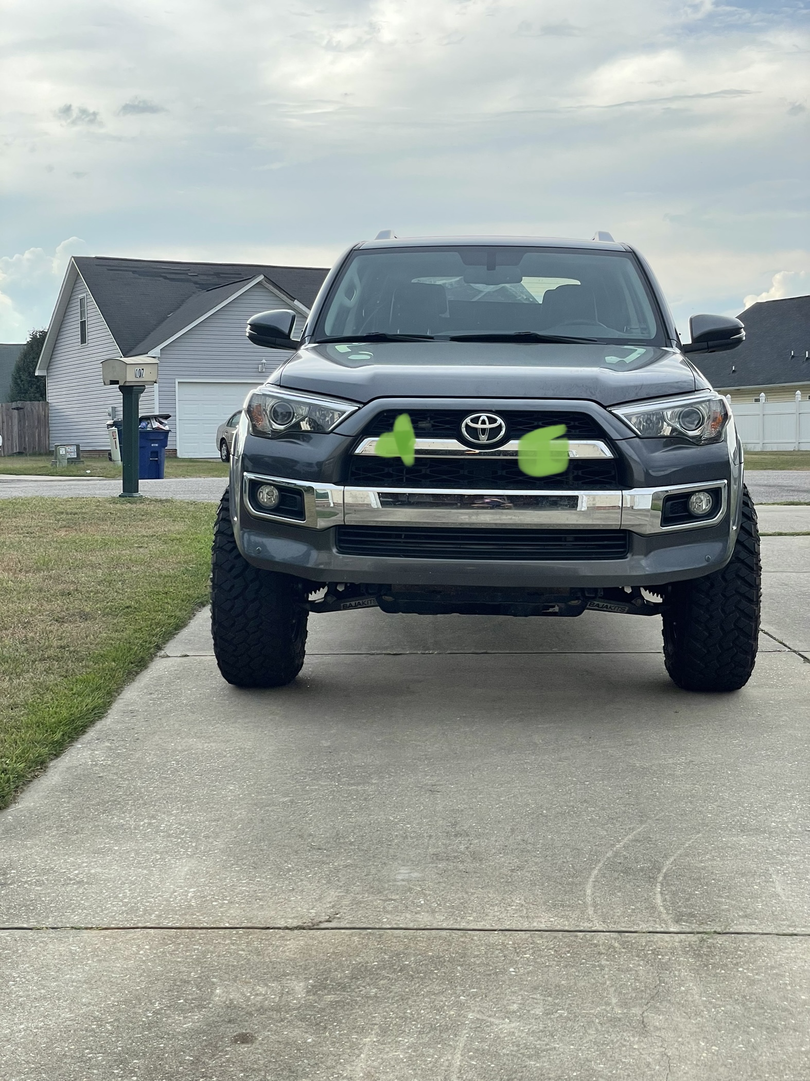

Has anyone cut the grill on their truck to slap 2 round lights like kc or Piaa in there? I have all the suspension done for desert running and i just don’t really like the idea of the light bar up top. Just seeing if there’s a good mounting point or even any spot at all that they can think of to make this work? Appreciate it and picture for reference.

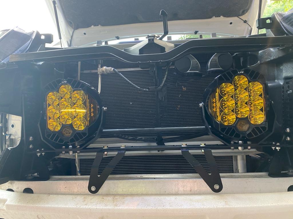

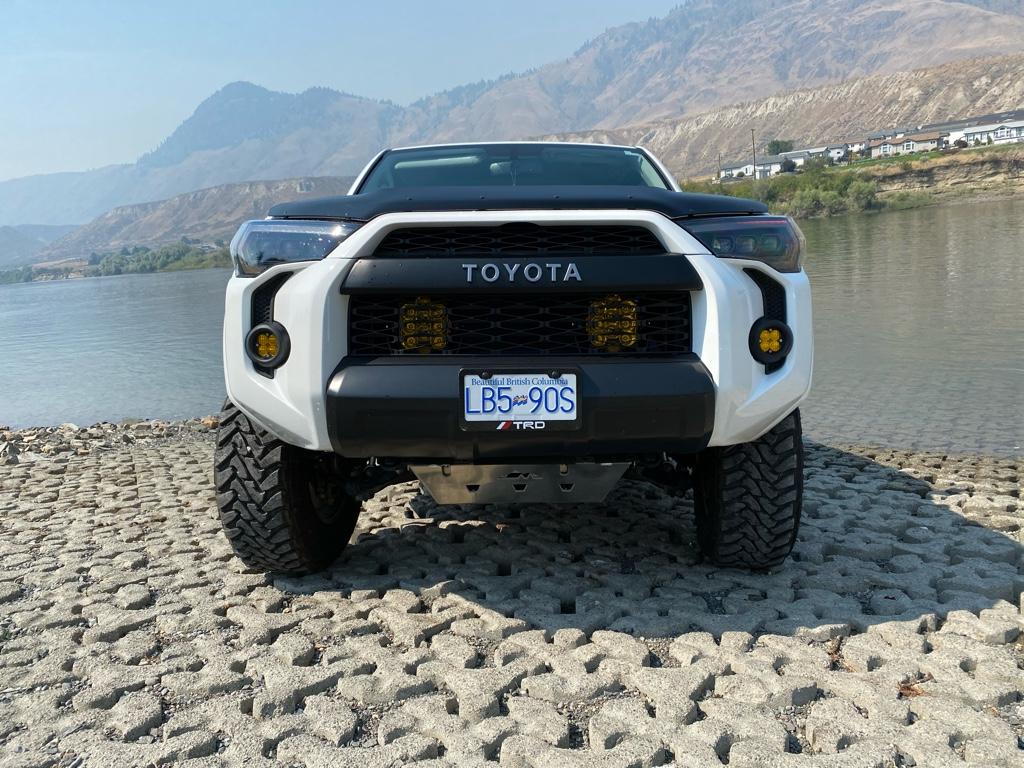

I mounted 2 BD LP9’s behind the grille but didn’t cut the grille out. Might be kind of what you are looking for.
I started with a Rago fabrication bracket but had to stiffen it up with two additional mounts in the middle.
Hope that helps if round lights are what you are after.

He has a limited front end...not gonna work unless he converts it to a non limited, or runs a light bar bracket, or chops his bumper. At that point, he might as well go aftermarket bumper.
I read the whole thread but didn’t pay close enough attention to the OP’s picture or the fact it was a Limited and couldn’t understand why everyone was recommending light bars when his question was for round lights …..I’m an idiot [emoji1].
I appreciate everyone’s input!! I cut the bumper already quite a bit and was hoping to maybe cut an inch more from under it and place a single tube below it with a skid plate because i honestly don’t mind the look after the cut. I think everyone is on to something with the light bar or the small cut out for the pods maybe. Like I said I was just trying to do something different. Your lights look sick though I would have definitely gone that route if I had a regular bumper

Supporting bracket
I
Hey! What bracket did you use to support the middle?
