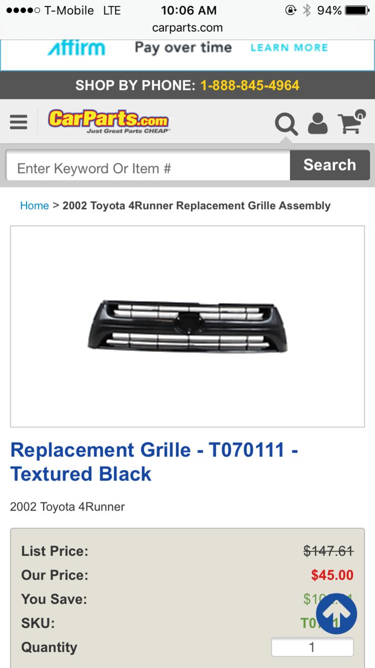

Will a Grille from a 2002 Runner fit on my 2000? I know they probabaly should but I wanna try this kind of grille instead of just doing a satoshi mod. I want to color match it and get a bronze devil horns emblem from Diaz Fabrication to match my SCS wheels :)

Yes, it will fit. To my knowledge, all 96-02 grills are interchangeable as far as fit. I put a 96-98 grill on my 02, because I preferred the style. Be careful of quality issues with that aftermarket product though. And order new clips, half the ones you have will break

You will probably have to dremel the tabs down a bit to fit the bulk head. They are too large. Besides that, they are pretty good quality.
