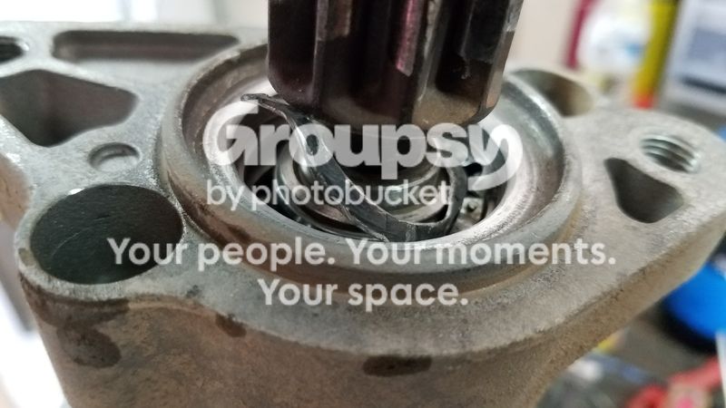

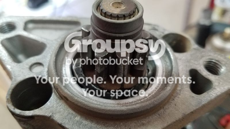

Mine did something similar a few months ago. It started out as occasional and then turned into every time I started it. Turned out to be my starter was bad. The front bearing on the bendex was shot and the retaining ring wasn't letting the bendex pull all the way back in so it was grinding on the flex plate. Looked to be the original starter from '99 though.
Was the first time I saw a starter fail like that.
20160719_112701.jpg~original
20160719_112715.jpg~original
Yeap like stated its the starter. The mechanism that kicks the gear towards the flywheel/flexplate is not working as it should. If you can find an OEM replacement or have a good known local company rebuild it. Its the best option. They are very hard to replace and you dont want to be changing a cheap auto part store one every year.
