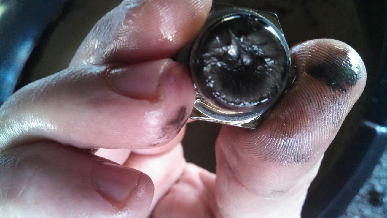

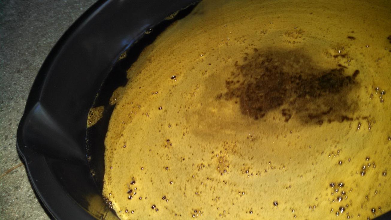

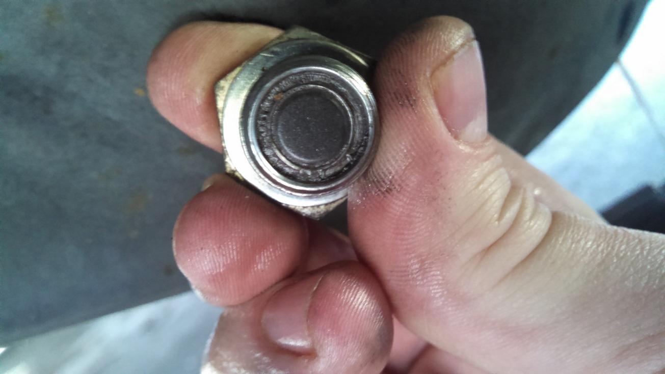

Finally got another day off. Changed the rear diff oil. Unfortunately, very little change in the sound/vibration. I am reluctantly giving in to the idea that it is more than likely my transmission. The pics were taken as I changed the oil about 10 minutes after a 10 mile drive.
I'm hoping the "foaming" is to be expected after driving. There were no chunks of metal, but lots of tiny metal particles. From what I've read, this part is natural wear.
