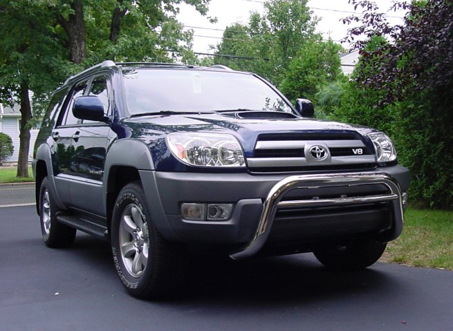

Ok here are some daytime pics...sorry didn't get the nerf bars...
Would like to see them installed myself.

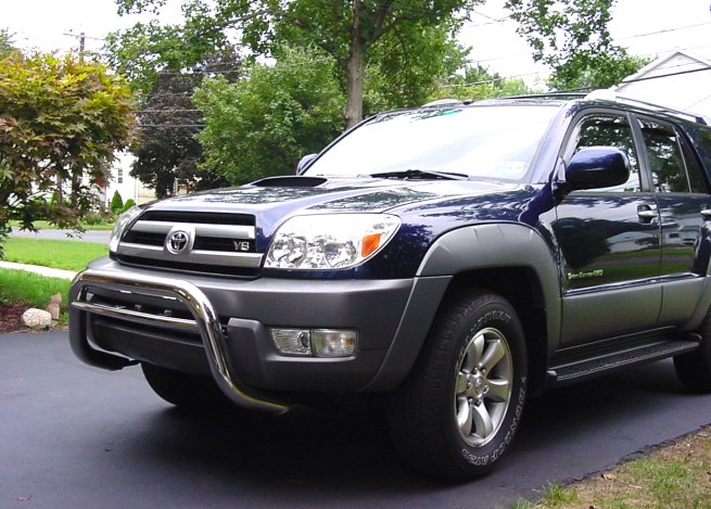

One more..!!
OK Guys...Now I need Help on what type of lights we should put on with these ?

That looks sweet! I also have an '03 with plastic cladding and was worried that the stainless would look too bling-bling with the cladding, but I think it just adds to the ruggedness on your truck. Very nice indeed!
