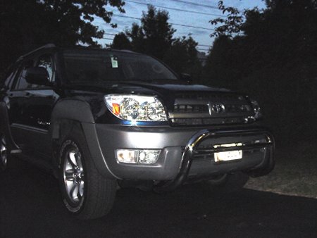

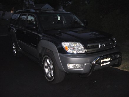

Ok guys just finished the install and here are some pictures ..
outoftown7 said:
Sorry they are so dark ... I whole job took me about 2hrs to complete.
NICE!!!!! What is your plan for your plate? Is it legal to have it partially blocked in your state? This is my concern right now as it's illegal in NJ i heard.

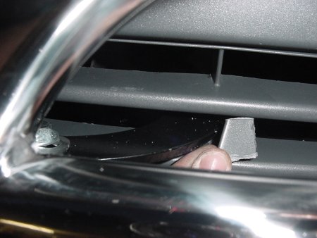

I am not sure about other years by on my 03 it bolted right up and as Scott said I first bolted up all the mounts to the frame and left them loose.
I started with the lower mounts only tightening them a little more than half way and then installed the bar. Once the bar was attached to the lower mounts I then tightened the lower mounts on the frame and then to the bar.
Next I installed the upper mounts. I did have to cut the grill for the upper mounts to fit and some pulling and bending to get it all to line up. Once the upper mounts were attached to the bar and tightened I then tightened the upper mounts to the frame.
Then just went over everything to make sure it was all tight

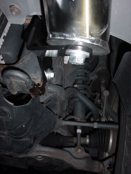

The last of the lower mount bolts..
I will try and get better pics of the runner with the bar installed in the daylight.

00328 said:
That's what I'm curious about, I'm not sure, but I believe the bull bar mounting brackets and the skid plate mounting brackets mount to the same place on the frame.
Anyone with the factory skid plate purchased the Strona (T&H) bull bar? Have you run into any trouble installing the bull bar?
I may have to move the plate down a litte...but tomorrow I will go across the street and ask my nighbor who is a lieutenant here in town what he thinks ??
It really only blocks off the very top part of the plate so we will see..

I received my bull bar and now I am trying to figure out how to install the bull bar's bracket with the Toyota skid plate already installed. I think I might need to do some work on the bracket.

I don't know how the toyota skid plate is installed but as you can see the bolts that came with the kit have some length to them so if the bull bar bracket will fit over the skid plate you may be ok.. just might have to bend them a little.
I am guessing that the toyota skid plates bolt where I installed the lower brackets to the frame ??

Yea this bracket thing is going to be a PITA. The top hole is already used with a bolt with thread So the bull bar top of the bull bar bracet above the hole can't fit. I may need to do some re-work to get rid of the nipple on the bracket.
