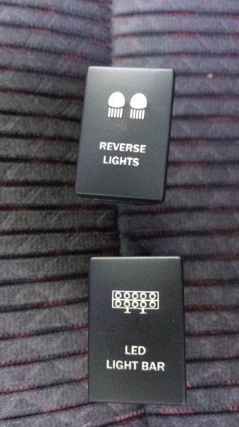

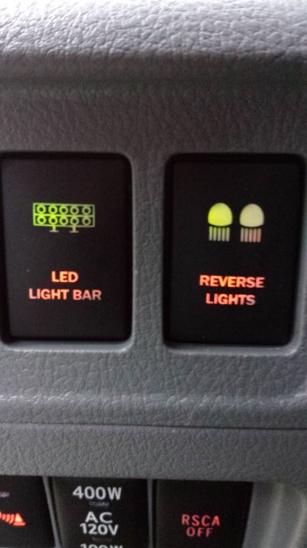

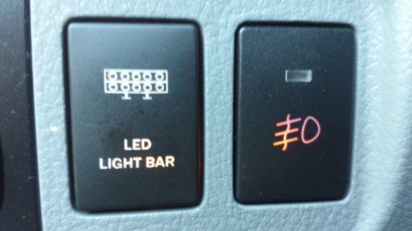

Wiring is exactly the same as Slee switches......plug and play. Not a fan of orange/orange color compared to my modded switch on right
So I pulled the switch housings apart, basically the only difference between the circuit boards is length, Slee is a tad longer, shaved approximately 1/16" off the front of the board with a razor knife, and reassembled

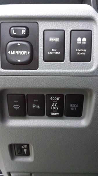

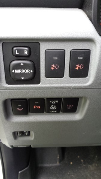

Before............
After :banana:
