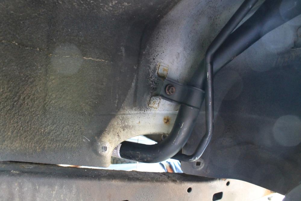

I did, actually. I brought it to my dad's friend's house(he was a racecar mechanic in his younger days), we got it up on jackstands, and found out there's this shield around where the brakelines run up the frame, and that shield is cracked, and was forced against the front driveshaft. It was holding the 4runner still when in 4wd, even without brakes on, now that it is pulled away from the driveshaft, it can roll, and doesn't click. I will try to post some pictures in the next few days.

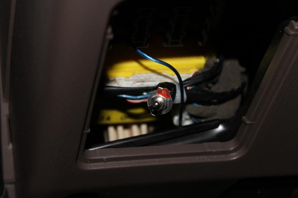

Got this switch hooked up, anyone know what for? Picture below: https://www.youtube.com/watch?v=eA-YAB383vU

I think go with aftermarket, these plates aren't very sturdy. The switch has been a mystery to everyone, I guess I'll just reveal it. Most people think it is useless, but it is useful for me in a crowded fire call, makes getting in and out easier. Just pay attention to the sounds, this is what the switch will be powering.
