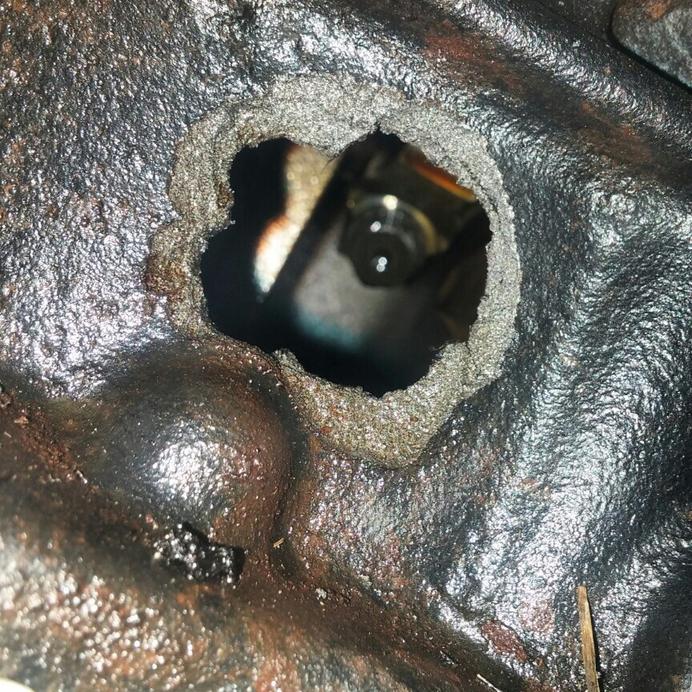

Take a guess, then I'll share some advice on how to prevent this...

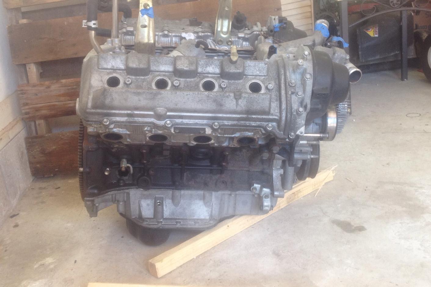

Might even make a write up on how to replace a 2uzfe in a 4th gen even though most won't need to in the next 20 years.
You hydro locked the motor or somehow miss shifted the transmission.
We have a winner! Hydro locked in 2 feet of water at 10-15 mph. 2 things that made stalling out twice as bad:
1. Stalling out right after giving the car next to me a smirk of confidence that my T4R can do anything with its aggressive look and stance.
2. Watching Miatas and Civics drive through the same pool of water with ease.
Since then, I've learned not to drive through 2 feet of standing water at 10-15mph with an off-road bumper that acts as a water funnel straight to your intake. I'm confident this would not have happened with the stock bumper.
Up until I had removed the engine and passenger side exhaust manifold, I had no idea this had happened. I was sure I'd bent a connecting rod since I couldn't manually turn the crankshaft a full rotation.
Since then, the off-road bumper has been sold and a donor motor should be up and running by Friday.

What bumper were you running? Many members including have done fording in similar water with plenty of aftermarket bumpers. Did you remove the fender liner completely or trim it? 10~15mph should have been enough to cause a protective bow wake.
CBI bumper. Fender liner was trimmed to the bumper, PIAA fog lights installed and probably blocked a lot of the water. After pulling the intake tube I noticed light coming through the fender from the dog light opening and immediately realized my failure.
The water wasn't still. I was following other cars who's wakes likely led to my hydrolock.
