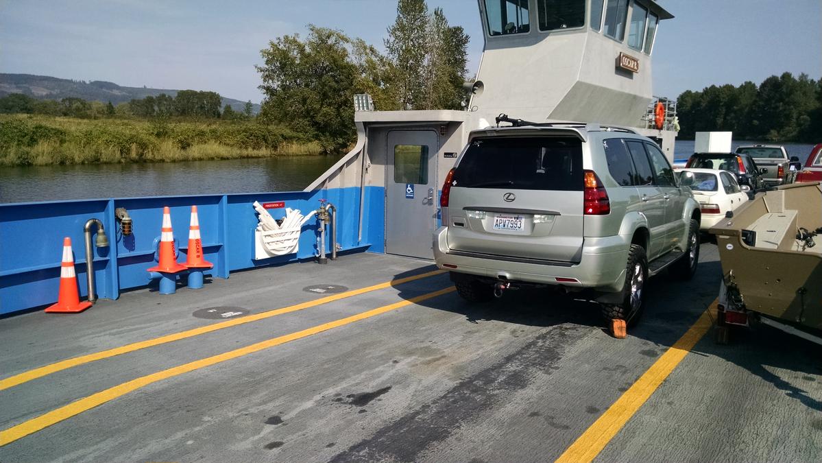

Took the GX across the Columbia River the other day via a ferry. Never been on a vehicle ferry before, kinda cool

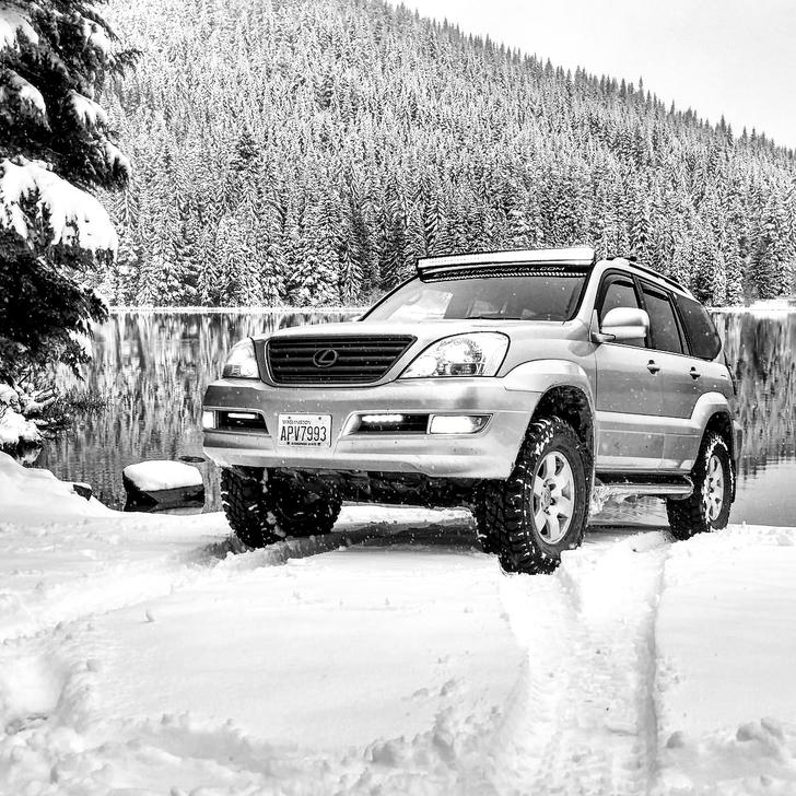

I took the GX out for some pre workout flex, after giving it some fjc and icon protein...

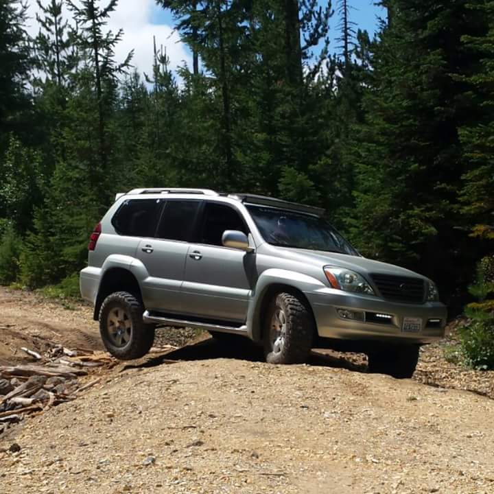

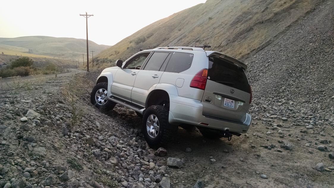

And one from an outing with the family and some friends. One of our friends caught this pic of me three wheeling it crossing a washed out section of the road... We later found out the road was closed when saw a USFS ranger who looked bewildered that three rigs came up on him in the middle of no where... He didn't care that we were on the road as we where not tearing anything up, and staying on the road. He was a really cool and down to earth guy. We ended up seeing him a few more times that day as we explored.

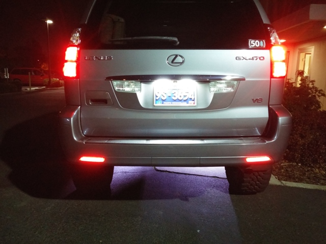

New pic and converted the rear reflectors to LED's
