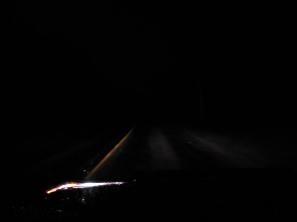

HID are coming to our life. I was wondering how they are perform on 4Runner. Let post some images of HIDs. I do not have them right now, but considering to get. This is the main reason of this thread to see the difference between stock OEM headlights and HID.
This image I've made last night. It was raining and I mentioned that my stock headlights aren't so good and fog lights doesn't make any difference. I'd like to see how HID will light the road.

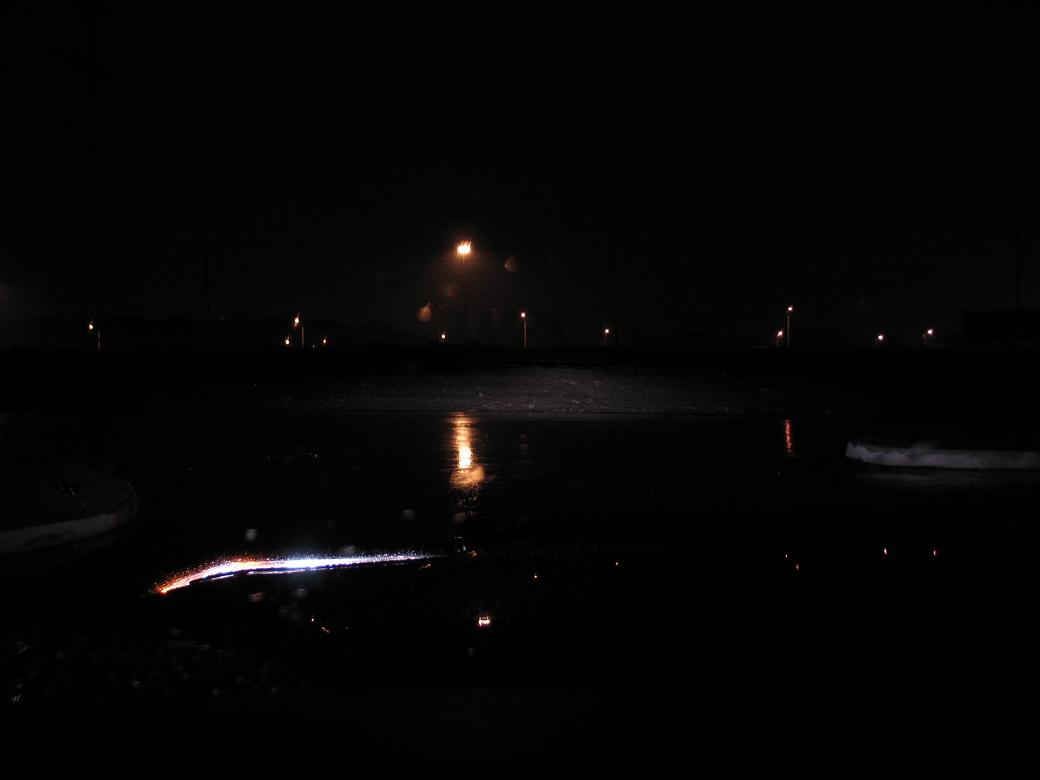

As you can see this is not a perfect image, so I did the same picture in parking lot:
