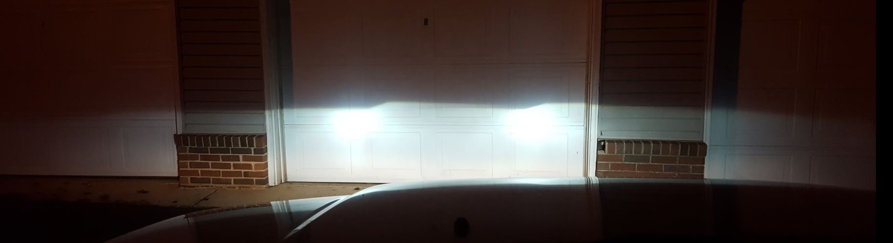

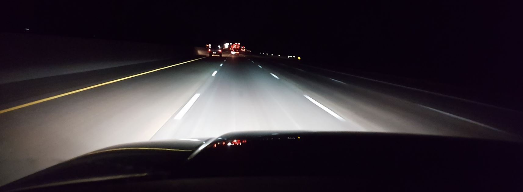

Here's two pics for you, close up against garage, night shot on highway. Headlights are still aimed too far down slightly, but night visibility is awesome.
Pics of previous setup and comparison are in this thread. It goes over OEM H11's, LED replacements and XenonDepot plug and play HID bulbs. All in OEM projector housing.
http://www.toyota-4runner.org/4th-g...headlight-bulbs-06-09-projector-housings.html
