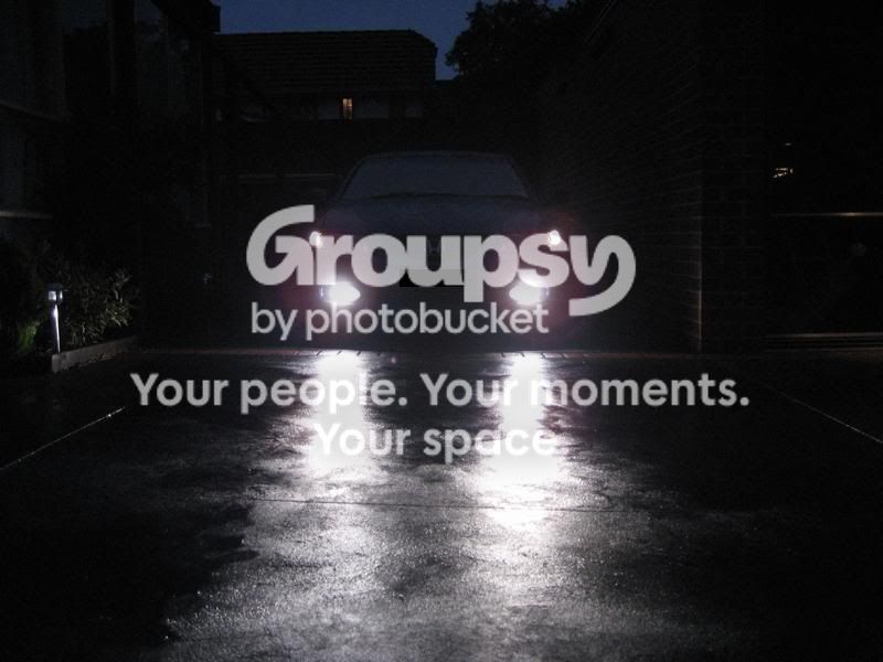

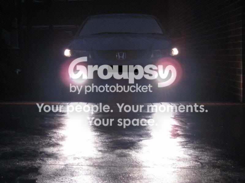

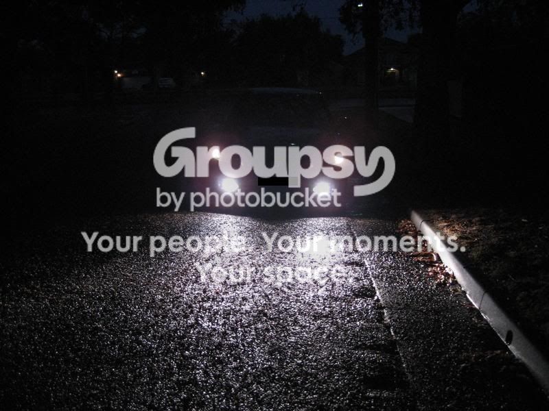

Someone put H9 bulbs in the fogs on a TSX
IMG_3477.jpg~original
IMG_3481.jpg~original
IMG_3478.jpg~original
