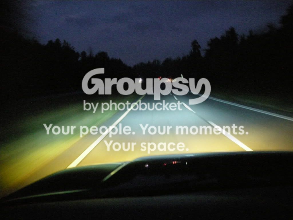

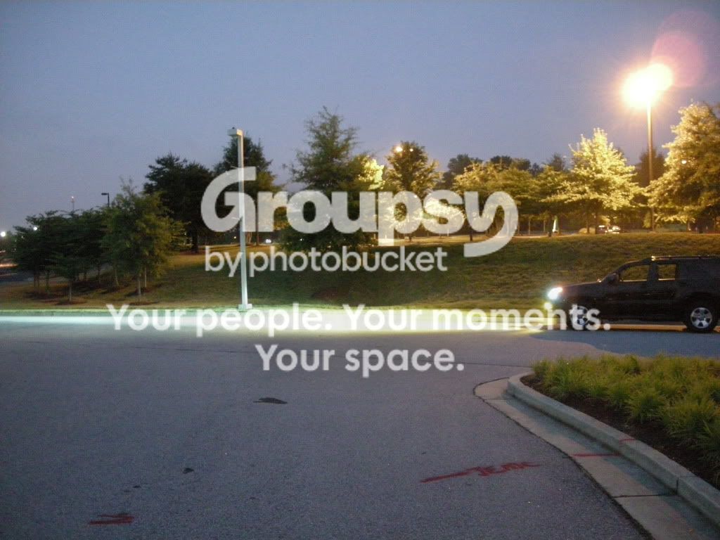

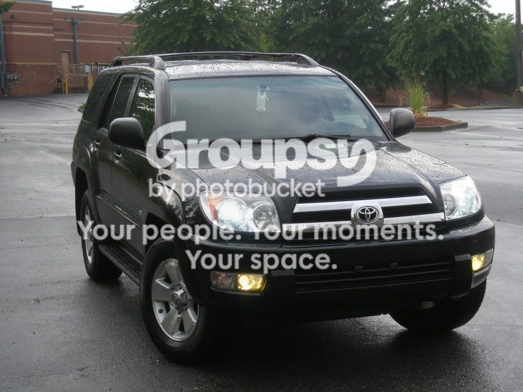

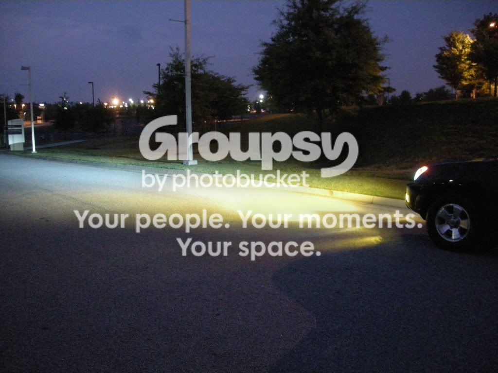

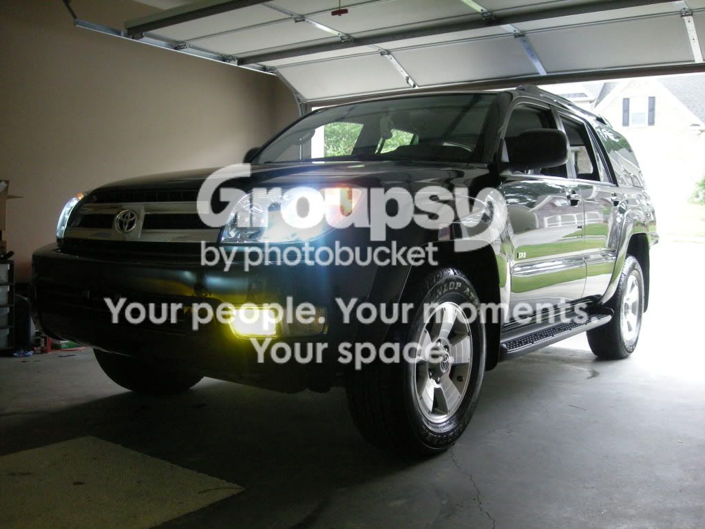

I have not seen good life out of the silverstars. On our 2005 4Runner both the low beams and the fogs are 9006. I had silverstars in them and I replaced them a couple times already. When I replaced one that was burned out I always replaced the other one that still worked, and I noticed that the filament looked like it was about to give. So I got fed up with replacing bulbs and now I have 8000K HID in the low beam and 3000K HID in the foglamps and I couldn't be happier.
