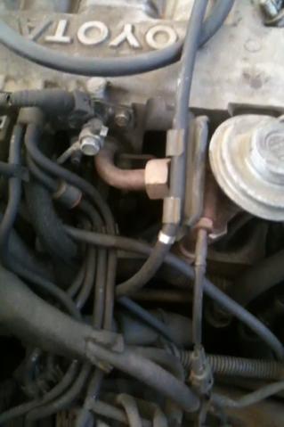

Cold Start Injector
Here is a picture of the passenger side of the upper plenum.
Right below the Y on the Toyota imprint on the intake is where the injector is, you can see a wire harness plugged into it and the banjo bolt that holds the fuel line to the injector, its to the left of the egr pipe.
