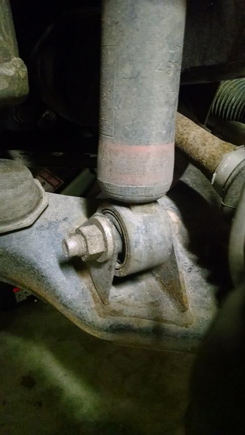

To update this thread, I put the front struts on (tundra 5100s) and so far the clunk has disappeared. Looks like it was the lower shock bushings. This is what the original strut bushings looked like (original struts, ~65k miles):

Well, scratch that. The clunk is back with a vengeance, even worse than before. I had my wife turn the wheel on the truck side-to-side to see if I could see anything moving that shouldn't be, and it looks like the LCA bushings are likely dead. I can see ~1/8-3/16" of total movement of the control arm front-to-back (of the vehicle). The uppers don't seem to be moving around at all. The clunk is so bad now that it basically does it continuously while driving. I'll probably order new LBJ's and a new steering rack guide to replace it all at the same time, might as well while the truck is up on stands again. I tried inspecting the bushings without moving the steering wheel and they only looked like they had some surface cracks in the rubber, but my guess is they are toast. I will probably replace with the Whiteline poly bushings and not OEM.
