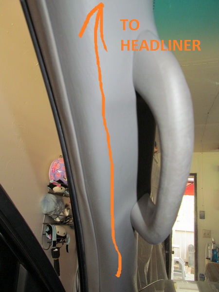

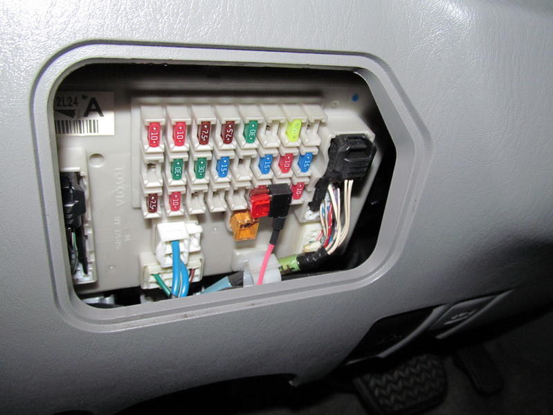

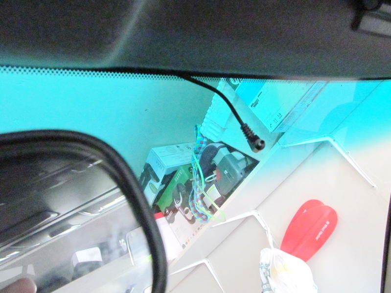

So you may wanna remove the pillar, pop the covers off the handle and theres two bolts. make sure the wire doesn't block your air bag, and run a ground to the map lights, tap the compass or mirror power. Easiest way to do it is to use the mirror tap cable (30 bucks but well worth it) where you just shove a prong in the back of the mirror, google it. I also have since filled the little hole with black epoxy putty so it looks better. I did it so I could have a remote by the throttle. where I tapped cig for power and then diced up the cig plug and ran 4 wires and a jack to the radar detector for the remote:
Hope these help! Let me know if you need anything else
