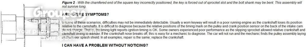

Improper keyway insertation
This is from a Miata web site. Numberous problems with the 1.6 engine destroying the crank keyway and balancer after removal and reinstalling after a timing belt change. Might be applicable to your situation.
Capture-1.jpg~original
To me it looks like a fail due to insufficient crank bolt torque. The balancer is not driven by the key; the key barely extends into the balancer (less than 1/4"). The balancer is secured by the massive 217 ft-lb. bolt torque pressing it against the timing gear. When the torque is not applied, all the resistive force of the driven belts is applied to that itty-bitty nub of the key as the crank forces it against the balancer keyway. The key deforms and effectively becomes a wedge expanding the inside of the balancer until it fails right at the end of the keyway.
Thus there is no deformation of the threads on bolt or crank because the bolt remains engaged--it just is not applying pressure to the balancer and timing gear. IMHO, the inspection report is BS.
