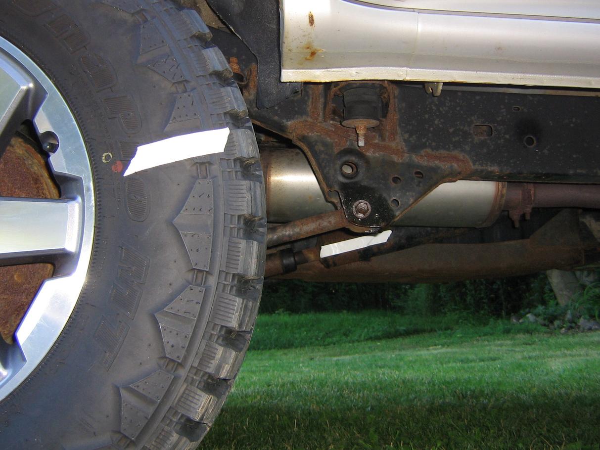

have you verified your 4:56 gears? i'm almost 99% sure the ONLY combo with 4:56 gears was the 3rz, manual, AND Elocker. But i might be wrong, so who knows...
Someone pulled up this old thread. LOL
I did the spin test last Aug with 2 pieces of white tape. & it's confirmed factory 4.56.
I dont even have the E-Locker light on my dash which sucks but my T4R is e-locked now.

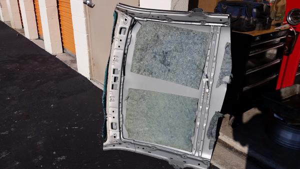

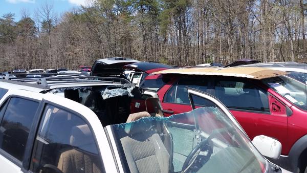

I was able to put a few hours into this a couple of weekends ago, removing the donor roof section from the parts truck:
I cut back far enough to keep the roof support for the non-sunroof roof in place - this will rest atop the drip rail lower flange and hopefully control the height and contour where I'm welding it across the roof skin.

Nice progress, I've seen folks use piano wire with broom handle pieces at each end. Mafioso preferred tool a Garrote, Lol windshield adhesive should be no problem.
