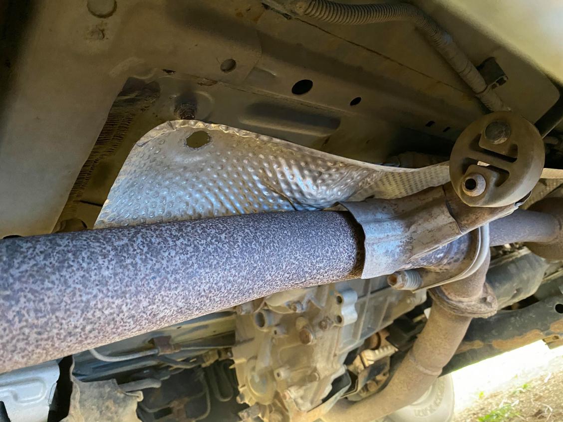

I got under the truck and pulled and prodded a bunch of bits and it turns out a heat shield was loose. The bolt and nut had basically worn away the hole and it was just hanging there. If I could lift it I could probably rivet the thing up myself, but as I don't I will have to find someone to reattach it.
