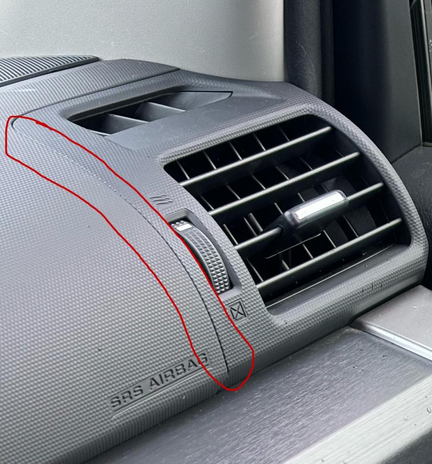

I’ve finally isolated a plastic cracking / rattling / sticking / clicking sound over bumps to where these two pieces of trim meet. You can recreate and temporarily exacerbate the problem by pushing on the vent side of the trim. Seems like that’s the piece that is flexing and making the noise when jutted against the larger dash trim.
Is it easy to slide out this vent assembly and try to wiggle it back into place? Has anyone successfully shut this noise up?
My mind goes to lining the gap with felt - but it almost feels like this is more of a very slight manufacturing tolerance discrepancy where the pieces are putting too much pressure on each other i.e. one of them is too large.
I had the clicking sound from that area and took out the vent to line it. I used masking tape since that's all I had but the sound is gone.
You will have to remove the knee airbag and the glove box to get the vent out.
YouTube Start-X install for instructions and then pull the vent out.
I've taken it apart a few times. Not hard. Do not unplug the airbag without disharging the system. Just leave it plugged in but make sure it's well supported and not dangling while you work.
