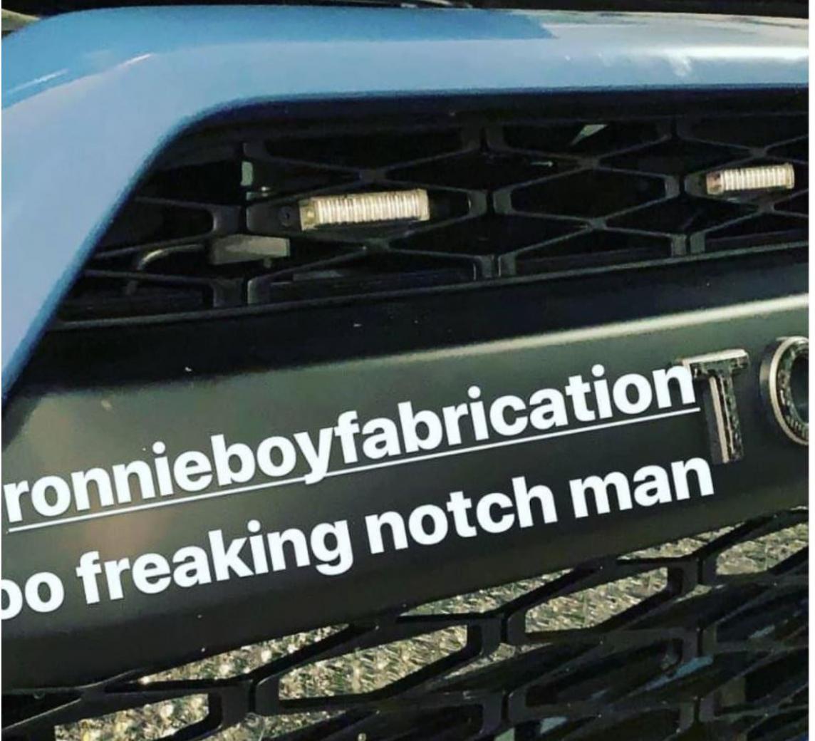

Dremeled out the sides so I can flush mount from behind. Used some shrink wrap on the ends like most do, and zip tied. Wired up with material I already had and it was like a $15 mod.

I was looking into buying new marker lights that would sit flush with the grill instead of sitting out front. I couldn't find any with the exception of the ones being sold on IG for $130 which to me is too steep for something I put together for $30 worth of amazon products. So I took a closer look at the lights the guy was selling to see if I could tell which brand they were so I can buy some online and replace my current ones. The closer I looked the more I swore it looked like he just dremels out the plastic on the edges of the Grand General lights and shrink wraps them so they look clean and fit flush. That's this weekends project.

If you didn't want to go the zip tie route a bolt & nut with a large washer behind the grille would do the trick (which I think some T4R user's did).

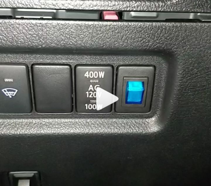

It is a cheaper route and you make your own wiring/switch if you want it which I actually don't mind, but Ronnieboy's brackets are just super tight and super clean and he also happens to do a pro quality job on the harness and makes it modular (add or subtract or swap lights down the road without redoing anything). And finally he went to the trouble to buy a ton of switch blanks from Toyota and retrofit a switch with your choice of color to match your interior illumination and make it all look super OE.
