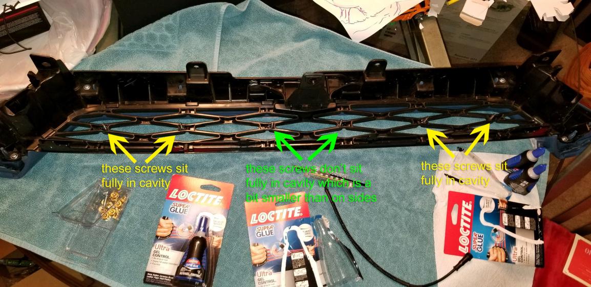

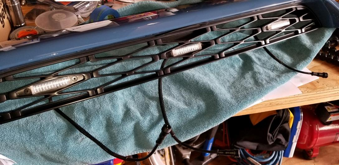

I just did the gluing and haven't had time to run the wire yet but I would say only other thing to share so far is that if doing the three light setup like mine (picture) note that the cavity for seating the screws on the four outer glue points easily accommodate the four outer screws on each end of the grill but the cavities in the middle for the two screws on the middle light are slightly smaller and do not accommodate the heads of the screws fully like on the ends. On the ends is easy, just fill the cavity with Loctite and gently press the screw fully into the glue filled cavity like shown in the linked YouTube in previous post making sure the screw is plumb. In the middle takes a bit more finesse as you need to wedge the middle screws a bit and then make sure to come back with more LocTite gel and fill around them. I also made sure to bond it a bit to the side wall of the cavity which is where I got a bit careless and got a small but of glue on the thread (hence warning above).
Finally... LET IT DRY COMPLETELY before doing anything/ I took my grill off and did this in the house because it's really cold here in the 30's now and thought it would be better to set up overnight inside. After fully dry (glue says 12-24 hours for full cure), fasten the lights but again not too tight. I actually left my middle light slightly slack because the grill is also shaped a bit different (concave) in the middle vs. more flush on the sides. If you tighten the middle screws down full it orients the light slightly different than the two outer ones where leaving a little slack in screw lets the middle light set flush.
Anyway this rambling of mine is basically finesse stuff and probably TMI for many but hopefully some appreciate the extra detail. I'll share more when I have time to wire it up.
Cheers JC

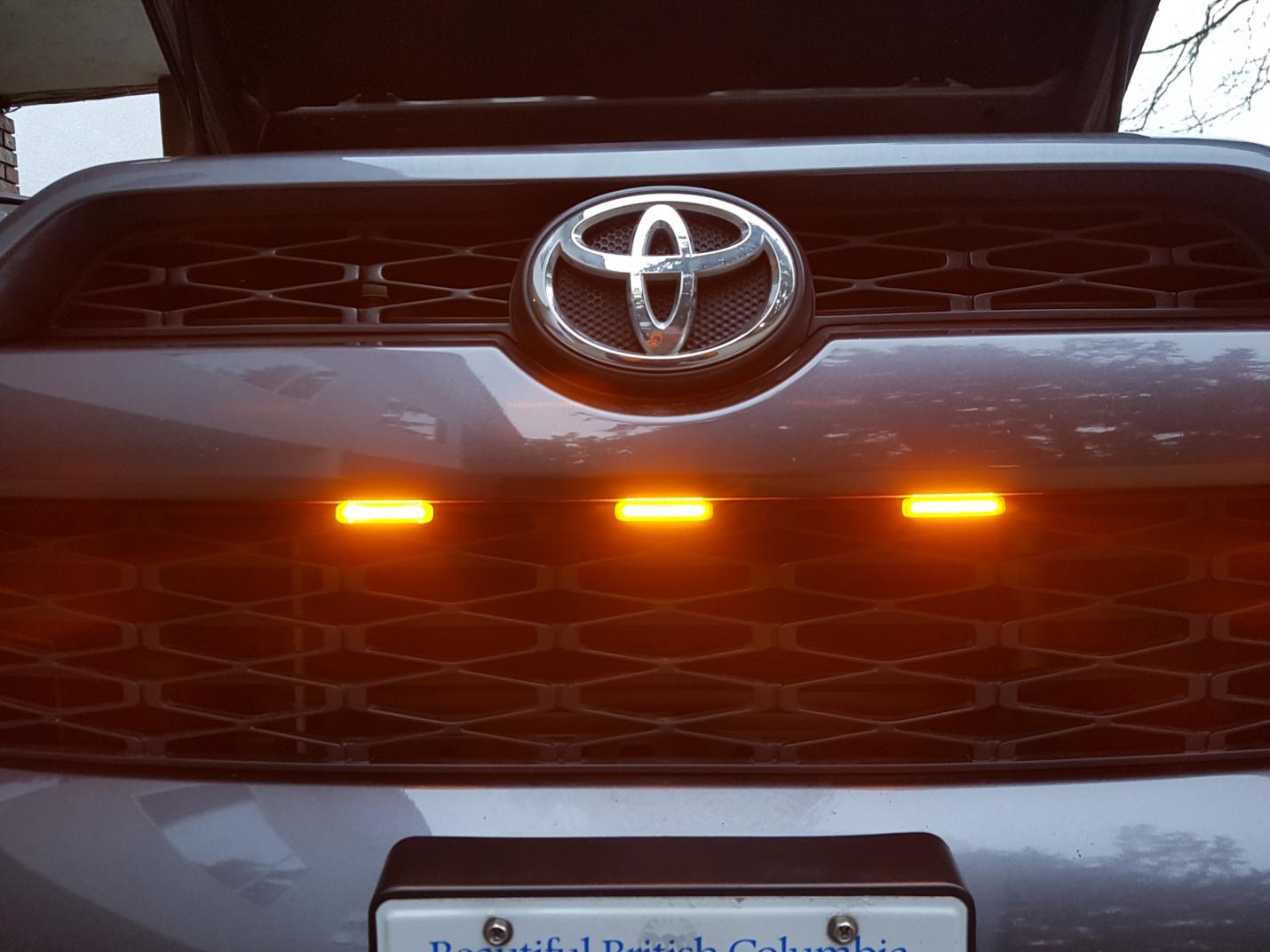

cheapest and best looking so far. you receive four but can choose to install 3. one of the fellow Canadian 4Runner owner (Sevag Merdinian) introduced this to the FB forum and also gave a 20% off discount code "4rled20". I am receiving mine this week sometime. after discount it comes out to be $44~.
Looks promising. Any installed pics anywhere?

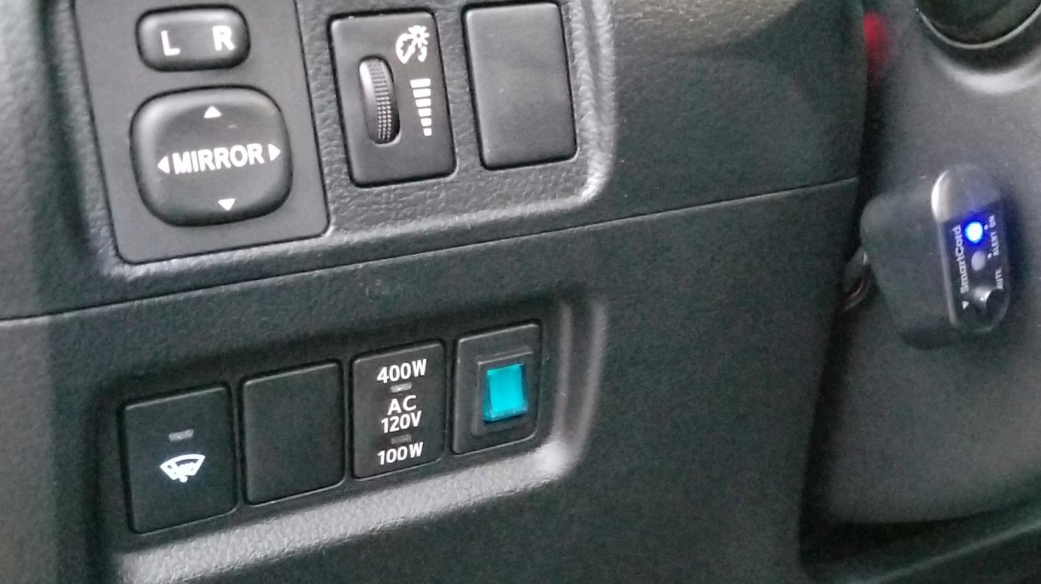

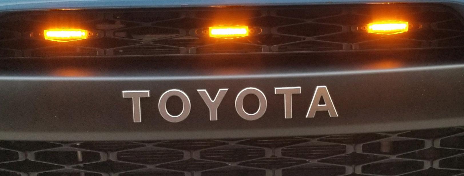

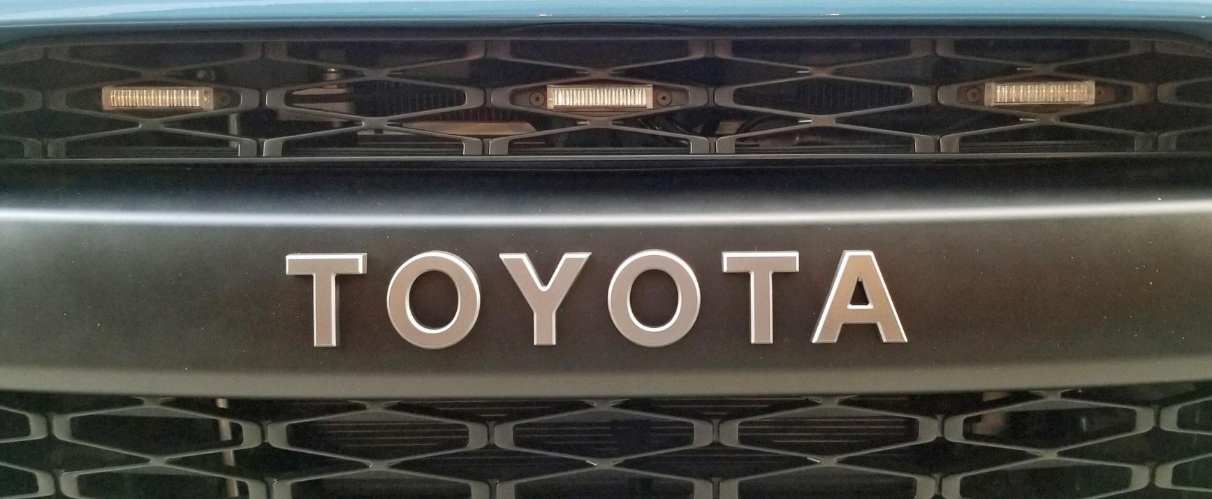

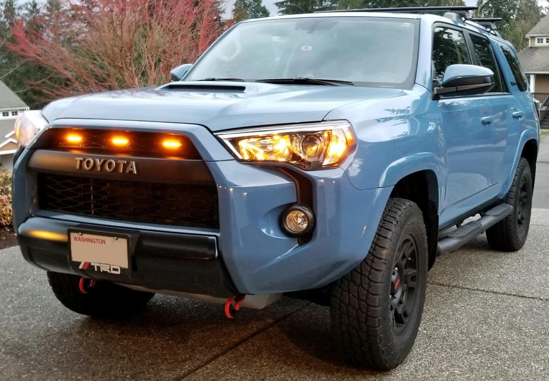

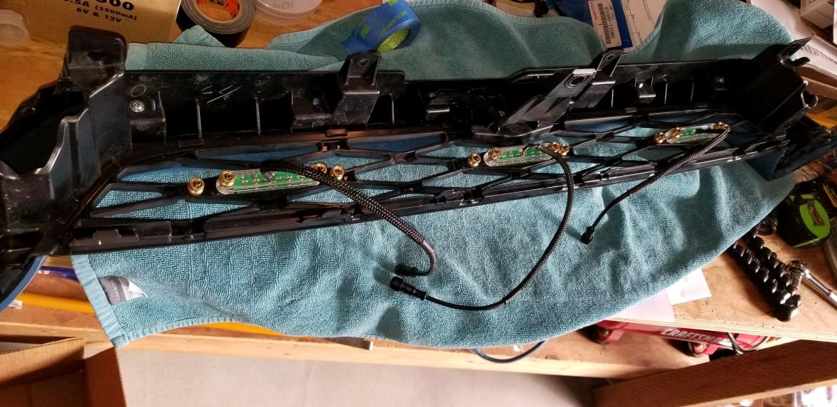

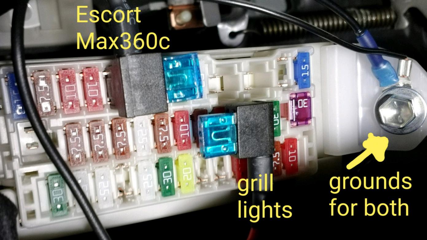

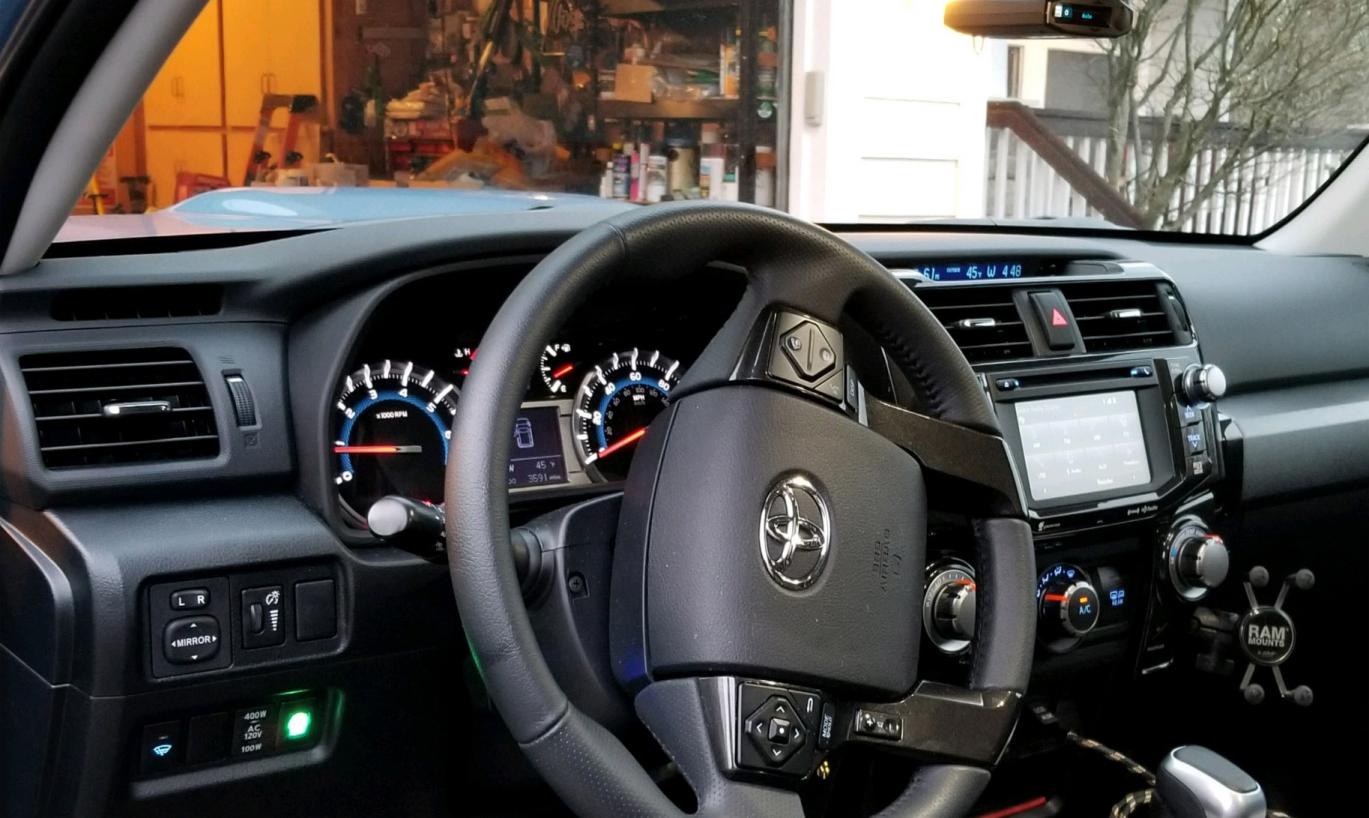

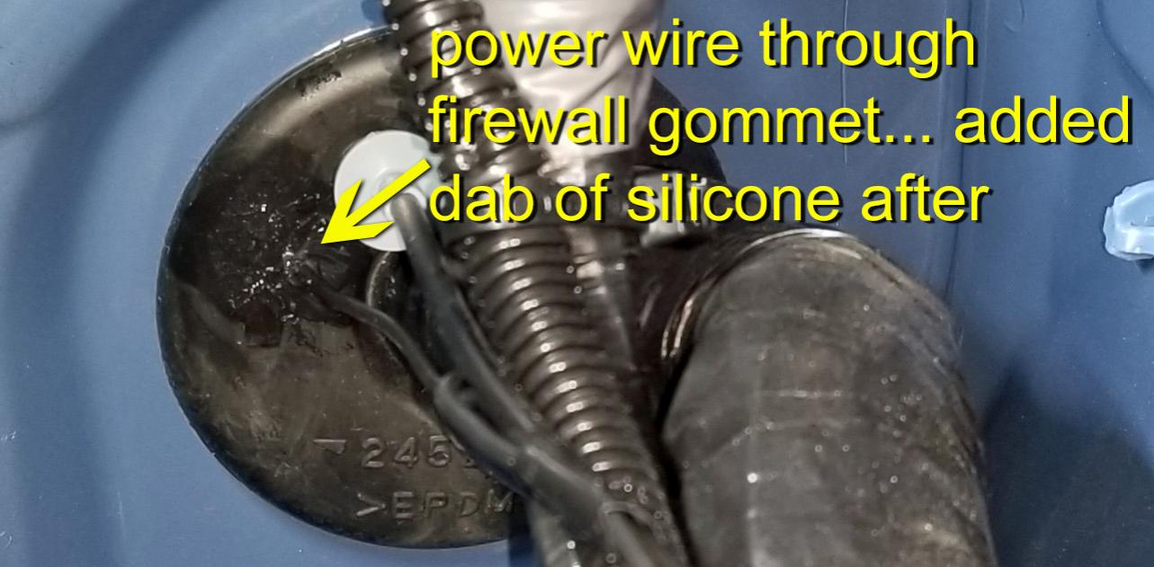

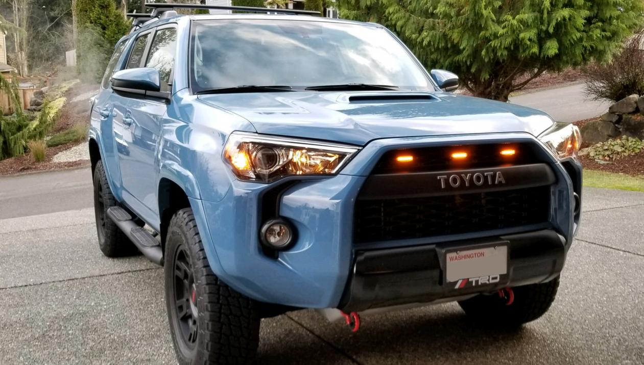

Here are some... just wired it up tonight... very happy except wish the switch color matched blue of other interior lights better.
Cheers JC
