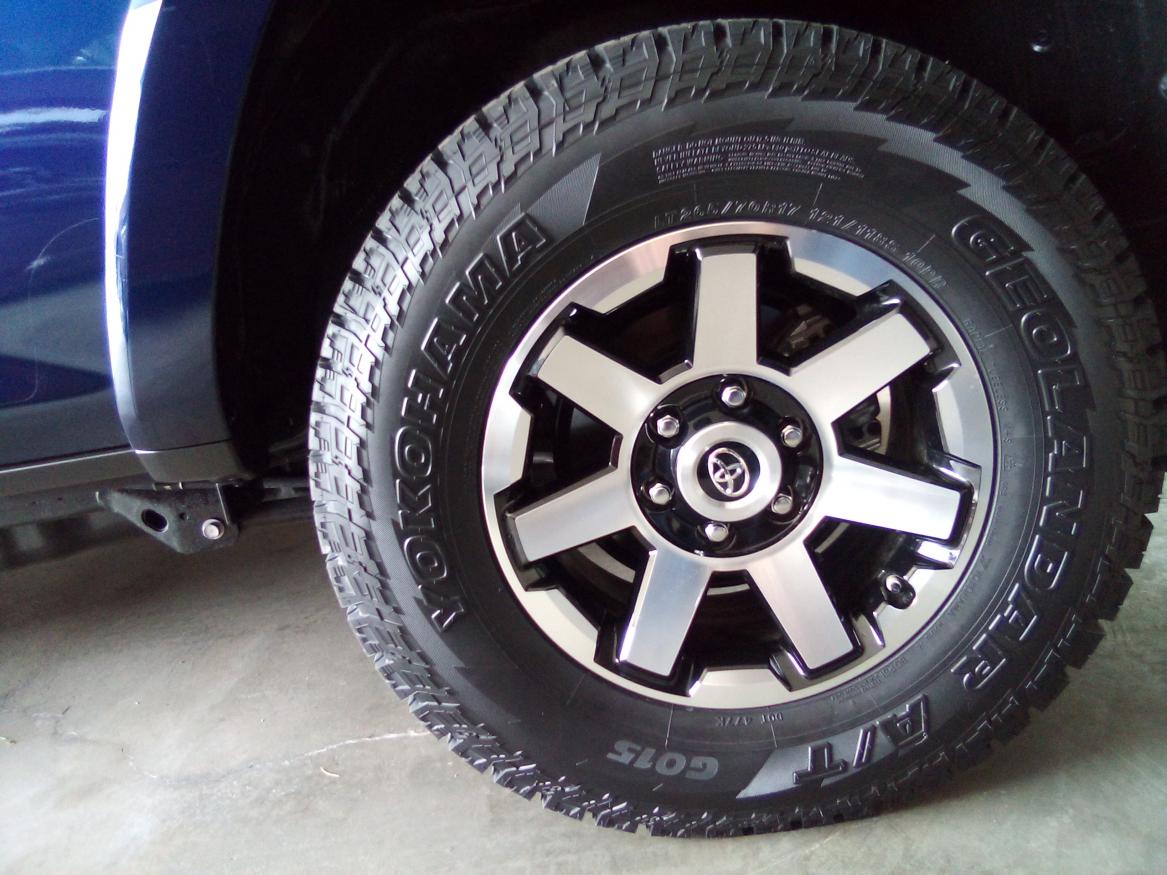

For the record, my 5th gen is now over five years old, and it's operated in the same conditions as my old 3rd gen was.
ZERO RUST. :thumb:
Look at this pristine frame that has had the Salt washed off when necessary.
